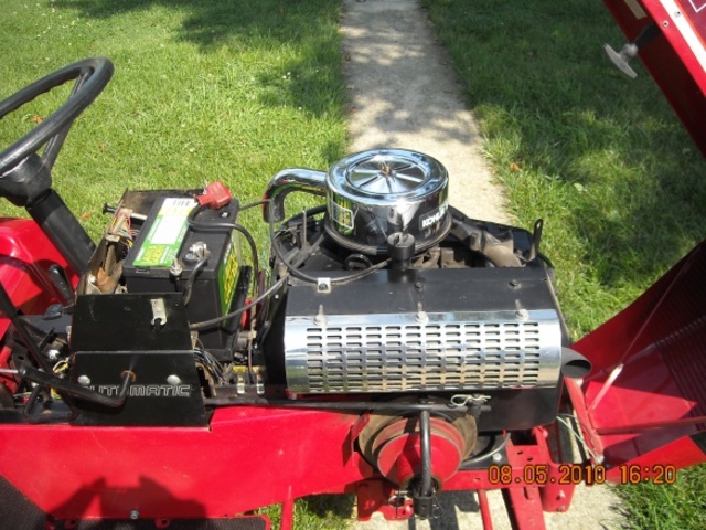

dhammer 2 #1 Posted February 8, 2014 Restoring my 1987 418-8 Wheel Horse. Completely disassembled and starting back up with it now. Remembering where almost everything goes but I am having a few problems with a few item placements. Is there any kind of assembly guide that would have pictures to show exact placement of all parts (ex: wire routing and bosch relay and pto spring placement). I already have the Toro parts manual but that does not show the placement of the parts on the tractor. Thanks for any help Share this post Link to post Share on other sites

dhammer 2 #3 Posted February 8, 2014 I have that schematic and have also used that website. The site shows the parts but does not show how the spring is mounted to the tractor with regards to location. A photograph would show what I need to see too. Share this post Link to post Share on other sites
Lane Ranger 11,814 #4 Posted February 8, 2014 There some photos in the gallery and if you do a search on Red Square you may get a 418-8 photo you can use to determine the spring setup. Share this post Link to post Share on other sites
Tankman 3,528 #5 Posted February 8, 2014 Try Parts Tree, excellent diagrams. http://www.partstree.com/parts/?lc=Toro+Consumer&mn=31-16K801 The link'll take you to the 416. Use your Horse numbers in the search. Share this post Link to post Share on other sites
Martin 2,133 #8 Posted February 8, 2014 (edited) in hindsight, you will remember to take pics before disassembly next time? most of the mechanical items placement is very similar from model to model. asking lots of questions or searching for pics is going to be your only option here. i have a few 3,4,500 series tractors and will help with whatever i can, fire away and see what we can do. the pto spring placement is similar over a bunch of tractors, its probably inside the hood stand. look for a hole in the actuating arm for the cotter pin.. if you need a pic of where the other end of the spring hooks to i will try and get one today. google is going to be your friend here too...... Edited February 8, 2014 by Martin 4 Share this post Link to post Share on other sites
chazm 413 #9 Posted February 8, 2014 (edited) Is this what your looking for ?? Edited February 8, 2014 by chazm 4 Share this post Link to post Share on other sites
dhammer 2 #10 Posted February 9, 2014 Thanks for all your replies. Chazm, that is the picture that shows it all. Thanks for the pic. 2 Share this post Link to post Share on other sites
