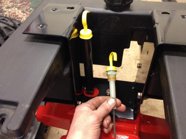

Martin 2,133 #1 Posted February 8, 2014 (edited) you guys that have 8 speeds, do you have short or long dipsticks? i think this is more related to the later models, but I'm not positive on that. my 1995 416-8 (the one I'm rebuilding at the moment) has a short one as oem. i hate it already and i haven't even put oil in it yet, or tried to reach it through the seat pan....... so what do you guys have? short or long? opinions good or bad? can't see why short would be good but if you think so, then tell me why..... (not sure if I've opened a can of worms here yet, I'm hoping this thread won't go south before i get some idea...) i found a long one from a spare trans and think i will be using it instead of the short one..... Edited February 8, 2014 by Martin Share this post Link to post Share on other sites

Martin 2,133 #4 Posted February 8, 2014 (edited) if its just under the seat pan you have a long. in my pic above, the short one I'm holding and you can see where the threads are on the tube. the dipstick handle is only just above, it almost sits on top of the transmission..... the long one i have screwed in the transmission in the pic...... Edited February 8, 2014 by Martin Share this post Link to post Share on other sites

rmaynard 16,700 #8 Posted February 8, 2014 It's a 1/2" NPT hole in the case for both, making either transmission interchangeable with the other. Just unscrew the tube and replace it with the one that will fit your model. Share this post Link to post Share on other sites
Martin 2,133 #9 Posted February 8, 2014 I'm not sure when they began to use the dipstick, but my 1976 and 1977 B-100's had dipstick envy. The short dipstick was made necessary by virtue of a bolted-on fender pan, and no hole in it for the longer dipstick tube to be accessed. The short dipstick could be removed from the rear by reaching under the fender pan. with the plastic tank under the seat pan, this becomes a problem, especially with the later fixed seat pan. theres only the large square hole to reach into... Share this post Link to post Share on other sites

Martin 2,133 #11 Posted February 8, 2014 It's a 1/2" NPT hole in the case for both, making either transmission interchangeable with the other. Just unscrew the tube and replace it with the one that will fit your model. thats what I've done Bob, the short one was what came with it, but i don't want to deal with it. the long one in the pic will stay...... this is more investigation than wanting a solution, all input is much appreciated though...... Share this post Link to post Share on other sites

Martin 2,133 #15 Posted February 8, 2014 (edited) looks like the final run of 315-8 tractors were short dippers..... so how do you guys with the later plastic tank/fixed fender/short dipstick tractors deal with checking the oil and/or filling it? do you bother to use the dipstick or just undo the side filler, like we all do on the old stuff? Edited February 8, 2014 by Martin Share this post Link to post Share on other sites
Don1977 605 #16 Posted February 8, 2014 My 1977 C-120 has a short dip stick and has the hole above in the fender. Getting it out is easy from the rear , getting it back in is the problem. It's hard to get enough pressure straight down, I have a stick with a slot cut in it to push down from the top. Share this post Link to post Share on other sites
leeave96 495 #17 Posted February 8, 2014 My 1997 year model 314-8 has a short tube/dip stick. I've got a long tube/dipstick somewhere in the basement I need to replace the short one with. Share this post Link to post Share on other sites
doc724 925 #18 Posted February 8, 2014 I hate those short dip sticks. First, your sleeve gets all greasy reaching down to get at it and then when you try to put the dip stick back, if you are getting on in years, that distance is the key "out of focus" point and you cannot find the receptacle. I recently picked up a 1998 314-8. It had the short dipstick. Since this one is going to be a keeper for me, I bought a long tube and dipstick from Kelly. I sanded it, painted it black and installed it. Just like my C141-8 (except that one is red!) Share this post Link to post Share on other sites
