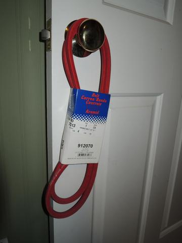

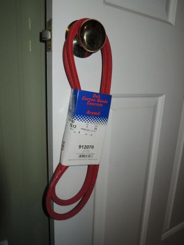

rmaynard 16,608 #5 Posted February 9, 2014 (edited) Just got a new belt for my 857. It's a Rotary brand Aramid 1/2" x 70" and...it's Wheel Horse Red Edited February 9, 2014 by rmaynard Share this post Link to post Share on other sites
