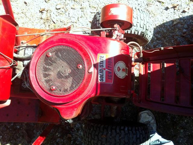

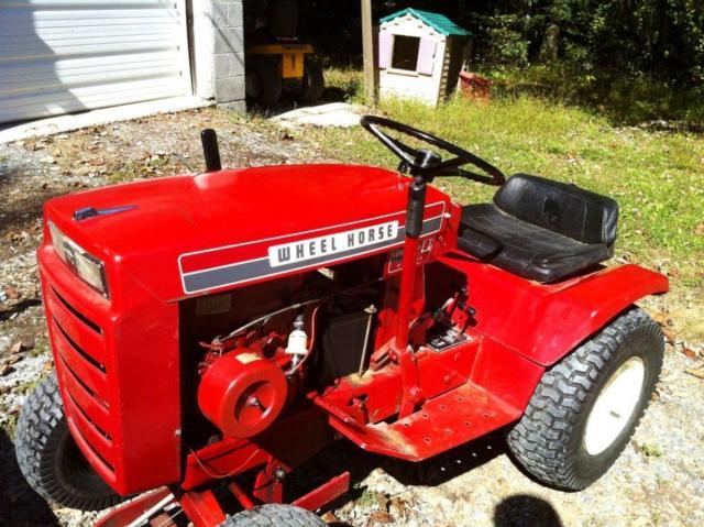

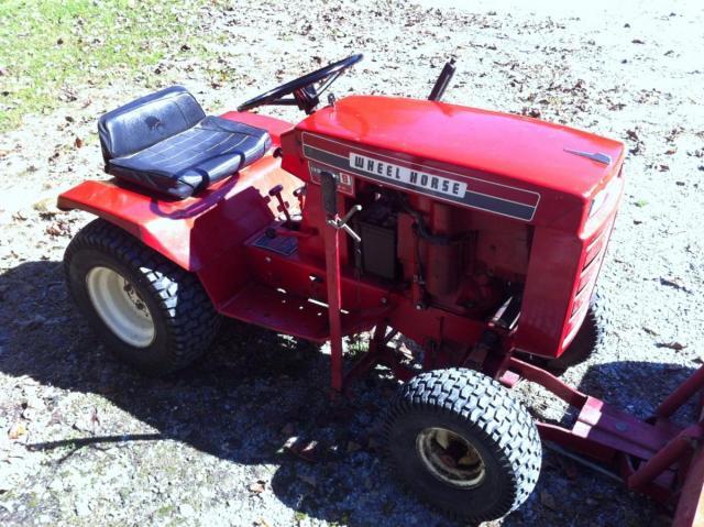

Eric_White 7 #1 Posted February 4, 2014 OK, got a 70 commando 8. When trying to plow snow, 3rd gear NOW goes slower than secondand grinds going into gear. Seems like loosing power all together. there is pleanty of 80w90 gear oil in the trans. anyone got an idea what is wrong? see attached pics 1 Share this post Link to post Share on other sites

stevasaurus 23,355 #3 Posted February 4, 2014 (edited) Nice looking horse. I like what Kai said about the belt. Is 1st and reverse OK? I would add to take a look at the hubs and those key ways...it does not sound like an internal transmission problem with what you said. Maybe check the input and engine pulley key ways also. Also, check to make sure none of the tabs on the belt cover are not broke...there may also be a tab or 2 mounted on the engine block or the tins under the guard. Edited February 4, 2014 by stevasaurus Share this post Link to post Share on other sites
