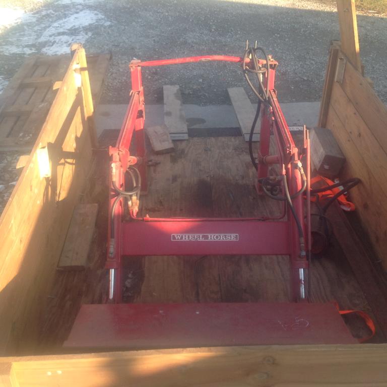

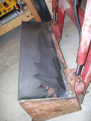

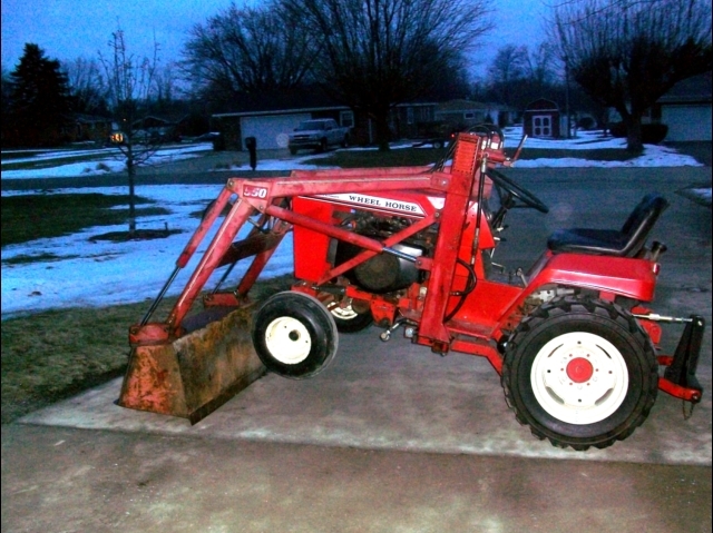

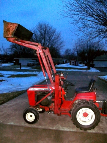

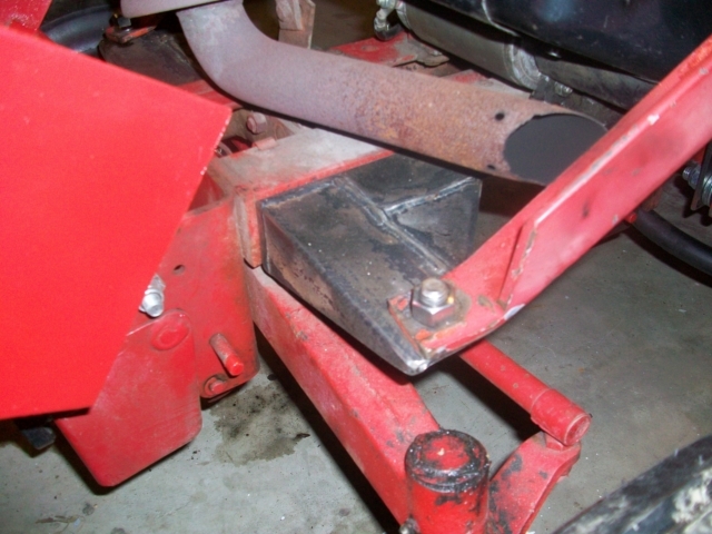

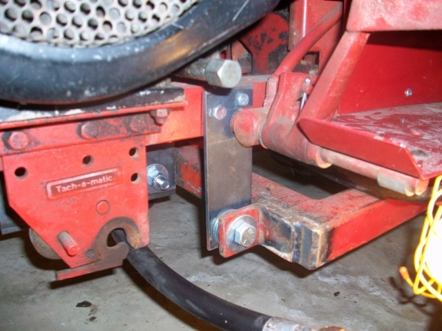

edwroy 138 #1 Posted February 3, 2014 Here is some pics of my current project. This is a '82 C195 and have added an Ark 550 FEL - I don't believe the 550 was for Wheel Horse - first coat of paint is orange. I had to modify the subframe to fit the 195. Also had to have weld shop make front mounts, make a pump mount, and replace the top of the bucket which was really dented. Now to make some final repairs and then to sandblast and powder coat. Thanks, Edwroy 3 Share this post Link to post Share on other sites

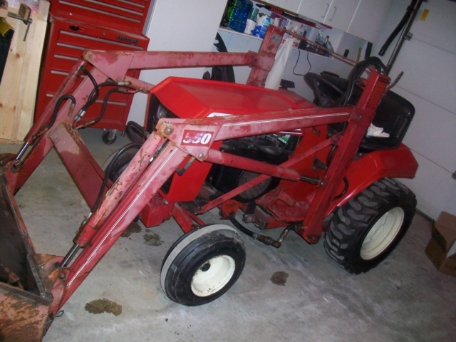

edwroy 138 #3 Posted February 3, 2014 More pics of modifications. Edwroy 1 Share this post Link to post Share on other sites
edwroy 138 #4 Posted February 3, 2014 Oh, I did add tri-ribs to the front - steers nicely. Considering 520 gear reduction modification as well. Edwroy 2 Share this post Link to post Share on other sites

AMC RULES 37,251 #8 Posted February 3, 2014 Nice looking welds there...machine is looking great. Share this post Link to post Share on other sites

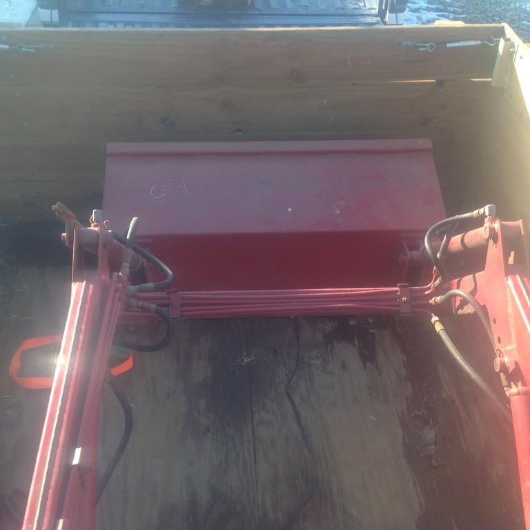

mattd860 162 #13 Posted February 3, 2014 Here is some pics of my current project. This is a '82 C195 and have added an Ark 550 FEL - I don't believe the 550 was for Wheel Horse - first coat of paint is orange. I had to modify the subframe to fit the 195. Also had to have weld shop make front mounts, make a pump mount, and replace the top of the bucket which was really dented. Now to make some final repairs and then to sandblast and powder coat. Thanks, Edwroy Nice looking tractor!! My foot pedal kit works nicely on the C-195's with Loaders - Let me know if you want one. Share this post Link to post Share on other sites

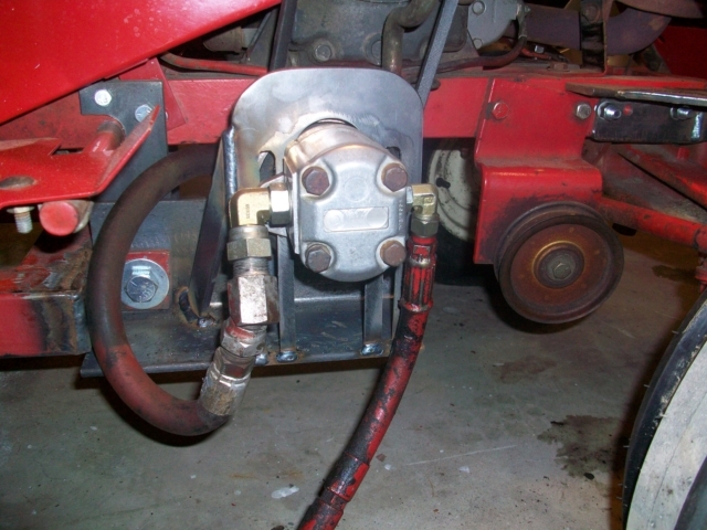

pfrederi 19,301 #14 Posted February 4, 2014 (edited) Very nice installation. I would consider adding a filter to the bypass line (from the valve bank to the reservoir). The reservoir is just the inside of the left hand support. They will rust inside and bit flake off and that is not good for you pump. There is a (or should be a screen) on the suction line (bottom of the support ) It will catch the larger chunks (assuming it hasn't been damaged over the years) but will let smaller abrasive material circulate. Northern tool has inexpensive bypass hydro filters. Some info on this here. Edited February 4, 2014 by pfrederi Share this post Link to post Share on other sites

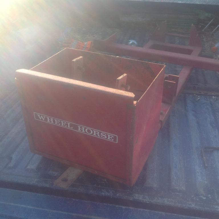

Horse Fanatic 51 #16 Posted February 5, 2014 Looks great! Are you going to make a weight for the 3 pt hitch? Share this post Link to post Share on other sites

Brrly1 1,146 #19 Posted February 10, 2014 Edwroy, the 550 ark loader was built for Wheel Horse tractors. It was put on the D series along with the D250. I have seen other pictures in the past. Even C series tractors with the 550 Ark loaders. I have to believe what you have is just one thats lost the sticker that goes across the front cross bar on the loader. If you look you just might find one. Good looking machine Share this post Link to post Share on other sites

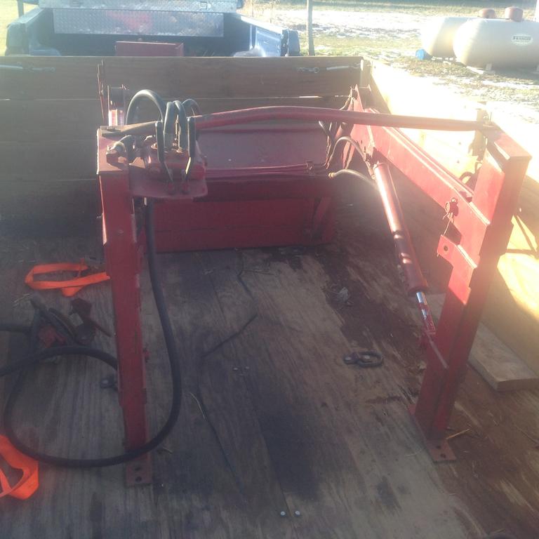

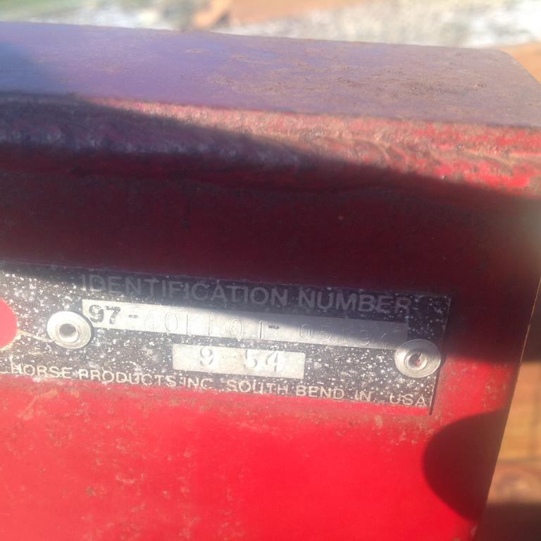

Rooney 5 #20 Posted March 11, 2014 The ID plate on loader frame says it was made by Wheel Horse. Does anyone know if this is an Ark loader or was it made by Wheel Horse. Share this post Link to post Share on other sites
dodgemike 52 #21 Posted March 11, 2014 Love the FEL's. Great job on the mods to fit your tractor. Show us pics when done painting. Sent from my SCH-S720C using Tapatalk 2 Share this post Link to post Share on other sites
MalMac 1,333 #22 Posted March 11, 2014 Yes it is a Ark. Ark made them for Wheel Horse and others. It just has a Wheel Horse ID tag on it. The tag is used to identify Wheel horses model number for the loader. Share this post Link to post Share on other sites
hm12460 53 #23 Posted March 11, 2014 That looks like a Barnes gear pump? If so, excellent choice! How much is it rated to flow? Share this post Link to post Share on other sites
Adams94 1,069 #24 Posted December 17, 2017 What did you have to modify on the subframe? I just picked up an ark 550 yesterday. Would like to put it in my c195 possibly 2 Share this post Link to post Share on other sites
