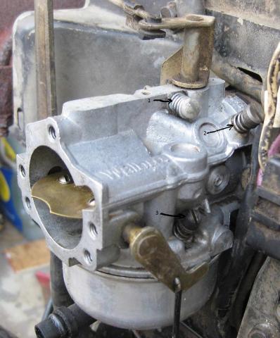

I have a 312-8 with a Kohler magnum 12HP engine that uses a Walbro carburetor.  Please see my attached pic and let me know which is the high-speed needle and which is the low-speed needle.  #1 on obviously the idle speed.  The Kohler manual only shows the somewhat different Kohler carb.

Thought i had the answer for ya but unfortunately my Walboro is a fixed jet unit and I can't be of assistance. . Someone with may more knowledge will be along to help you I'm sure

 Number 1 is the idle speed adjustment, and number 2 is the low speed adjustment, 3 is the main jet

Bob Maynard is correct. You may need to remove both the high speed and low speed needles and clean them, plus take a can of spray brake cleaner and spray down in the passageways. Not the whole can, just a little bit.

All walbro carbs that came on magnums have fixed main jets aka high idle

They did that for emission purposes
