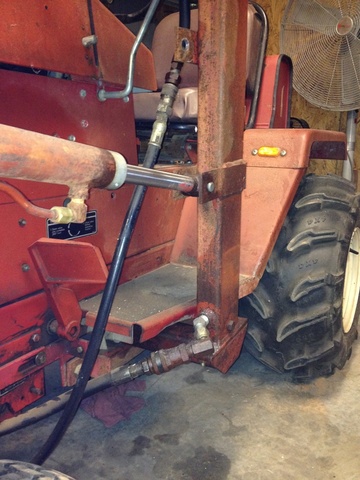

shorts 182 #26 Posted February 6, 2014 You're on the right track, a 1/2" ID pipe will flow about 2 times as much oil as a 3/8 ID fitting and then use the 3/4" low pressure hose, it will flow 2 times as much oil as the 1/2" pipe which will reduce the suction stress on the hose, what looks like "not much" is actually double the supply and that's huge in this instance Share this post Link to post Share on other sites

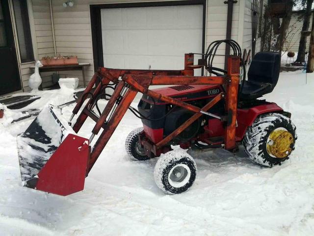

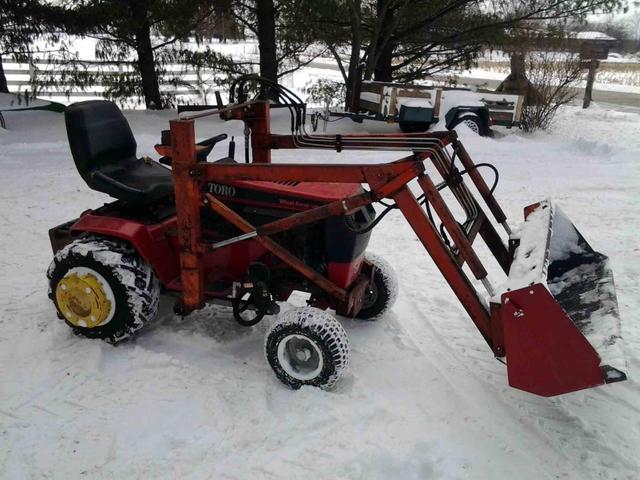

Dieselcowboy 211 #27 Posted February 8, 2014 (edited) My have I learned alot in the last week on hyd. A hyd pump is like a dog, if you want it to work for you, it needs to be fed. With that it also needs a place big enough to pee. Thank you Shorts so much for the help. This loader flies now. The pump runs very quite at all rpms. Very cheap repair from what I was expecting. You guys must really know what you are doing just from looking at a few pics and picking right up on the problem. Speaking of that here is a pic of the update. And tomorrow I'm going out and scoop some snow around. Really excited ! Edited February 8, 2014 by Dieselcowboy Share this post Link to post Share on other sites
shorts 182 #28 Posted February 9, 2014 Good deal, glad you finally have a properly working hydraulic system. Always happy to be able to help you learn about basic hydraulics, something that you can use in the future. Now go back and finish your pump plumbing by installing a second hose clamp at each end of the suction/supply hose, turn the second clamp so that the screw is opposite of the first clamp to prevent any air from entering at the fitting. Share this post Link to post Share on other sites
