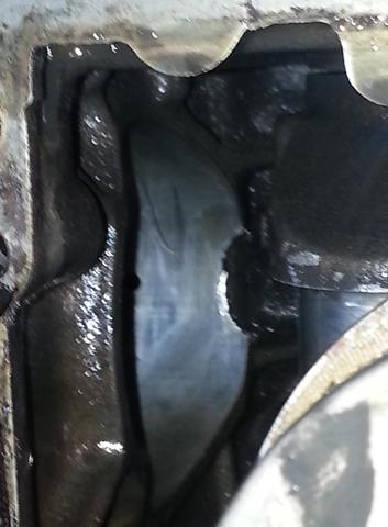

Pettson 3 #1 Posted February 2, 2014 Scrap or can it still be used?!? The mark is at the bottom of the cylinder. no marks on the piston or higher up in the cylinder. Best regards Pettson Share this post Link to post Share on other sites
WH nut 553 #2 Posted February 2, 2014 I have used blocks that look like this with no problem. Just make sure there aren't any cracks that will cause problems later Share this post Link to post Share on other sites
bewford 21 #3 Posted February 2, 2014 I have used blocks that look like this with no problem. Just make sure there aren't any cracks that will cause problems later X2 Share this post Link to post Share on other sites
Fordiesel69 271 #4 Posted February 2, 2014 Grind it silk smooth, no jagged edges. It will damage the piston skirt if left that way untouched. Share this post Link to post Share on other sites
Pettson 3 #5 Posted February 2, 2014 (edited) oki thanks! any one got the part nr 4 the connecting rod and 2 pistons. Found Connecting Rod (.010 U.S.). But what is thate .010 u.s? will it replace std c rod? kohler k532s-53138a Edited February 3, 2014 by Pettson Share this post Link to post Share on other sites
bewford 21 #6 Posted February 4, 2014 If I remember correctly the pistons are 12hp k301. The .010 under rod will require that the crank be ground. Share this post Link to post Share on other sites
