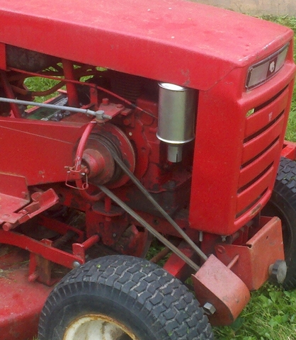

sorekiwi 761 #15 Posted January 31, 2014 In my opinion the Gravely muffler works great on the little Kohlers, but is still a little loud on the big block Kohlers. The Cub Cadet muffler of the same style (but longer) is quieter again. Quietest of all the mufflers I have tried is the Nelson that came on the B and C Series tractors as OEM. The Gravely: The Cub Cadet: 1 Share this post Link to post Share on other sites

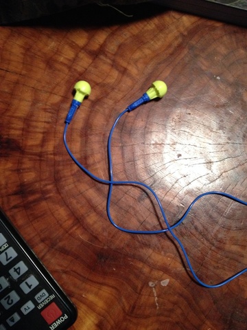

brandonozz 168 #19 Posted February 1, 2014 I've heard lots of good things about this muffler also. You better address this ringing situation asap because if you don't there will come the day when the ringing does not stop, ever. Like Van said, Hearing loss in nothing to mess around with. I was not very smart when I was younger and really didn't know much about hearing loss and even what ear plugs were. I don't really think you will be able to quiet a horse down enough that hearing protection isn't needed. Sure, you may be able to tolerate the noise but that doesn't mean your hearing isn't paying a price.There are many different kind of plugs and you should be able to find some you can live with - in my line of work it isn't an option. My favorite is the simple push in as they are quick to insert. Of course, this time of the year muffs aren't bad either. 3 Share this post Link to post Share on other sites
