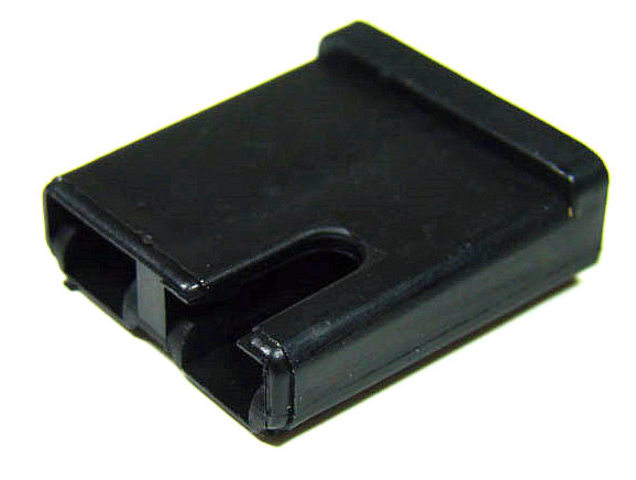

Wishin4a416 2,597 #1 Posted January 31, 2014 (edited) I am making a new harness for the 160 and need 2 connectors. My harness was pretty well molested and these were gone and bypassed. Thes are the PTO and Clutch Safety connectors. Would these be available at DelCity or PCS? I dont know the name for these in the Industry. I need to order some more Terninals and would like to throw these on the order if available. Picure # 36 in schematic and part number 106024. Edited January 31, 2014 by Wishin4a416 Share this post Link to post Share on other sites

Martin 2,134 #3 Posted January 31, 2014 (edited) that plug looks like the plugs that GM used on neutral safety switches on some Australian cars back in the 70s. Im sure that they were used over here too. I bet that they are a Packard part so some searching might come up with something. I will try a few sites and see what i can come up with. just seen your post chasm, that 2 position plug is different from what is needed. the terminals are in line and the plug end is exposed on the side for the 'pins' to go into the terminals.....where as the one you pictured is at 90 degrees to each other... Edited January 31, 2014 by Martin Share this post Link to post Share on other sites
Martin 2,134 #4 Posted January 31, 2014 (edited) heres a start..... half way there, i guess..... http://www.pcsconnectors.com/2977647.aspx don't have anymore time this morning, this is a start though........ its a Packard 56 style connector....... Edited January 31, 2014 by Martin Share this post Link to post Share on other sites

Wishin4a416 2,597 #6 Posted January 31, 2014 Thanks guys. That would be it Martin if it had both slots. Share this post Link to post Share on other sites
TT-(Moderator) 1,170 #7 Posted January 31, 2014 Standard Motor Parts S647 - but they already have the leads installed: http://www.summitracing.com/parts/smp-s647?seid=srese1&gclid=CK2Qy_WjqLwCFQHNOgodukkAkA Share this post Link to post Share on other sites
Wishin4a416 2,597 #8 Posted January 31, 2014 (edited) Heres the one I have Trouty. Edited January 31, 2014 by Wishin4a416 Share this post Link to post Share on other sites
Wishin4a416 2,597 #9 Posted January 31, 2014 Thats it TT. Thanks! But wow 32 bucks for 2. I will look around some more for just the connectors Share this post Link to post Share on other sites
TT-(Moderator) 1,170 #10 Posted January 31, 2014 Try Delphi 2973407 1 Share this post Link to post Share on other sites
doc724 927 #11 Posted January 31, 2014 When I re did my C141 I also had to get the Packard connectors for the ball switch. PCS has them (singles only). They snap right on those turrets on the ball switch. The ball switch (if you need it-mine was bad) was and is still made by Pollack in Canton, MA. Go on line and look for Pollack Ball Switches. Send them an e-mail and find out where is the nearest distributor. They come in various terminations (screw, quick connect and turret type) Share this post Link to post Share on other sites
"D"- Man 827 #12 Posted January 31, 2014 I found some on E... Item #321064823980 I do not know if this is like the one you need but it fit on a neutral safety switch that I have, Mark. Share this post Link to post Share on other sites
Wishin4a416 2,597 #13 Posted January 31, 2014 Thanks Everyone. I am good to go now I think. Share this post Link to post Share on other sites

Wishin4a416 2,597 #15 Posted February 1, 2014 Thanks again everyone. I have a 5 pack coming @ 3.99. Went ahead and got some more terminals as well. Share this post Link to post Share on other sites
tbarnhart 240 #16 Posted February 1, 2014 Also available from your John Deere dealer. It was used on the neutral start switch on 4020 up to the 4450. Part # R77480 Share this post Link to post Share on other sites
