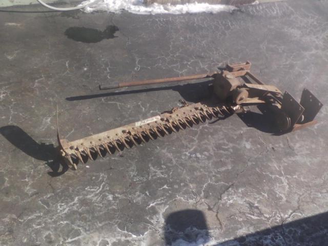

HorseWhisperer 243 #1 Posted January 30, 2014 Woot Woot is all I can say!I patiently waited out a sickle bar search and poached one down in Laceyville PA this morning.looks complete with no chipped or missing anything but the transport bar,good belt,grease on the Jack shaft bearings and honey in the gearbox!Took me three years but color me smitten! 3 Share this post Link to post Share on other sites

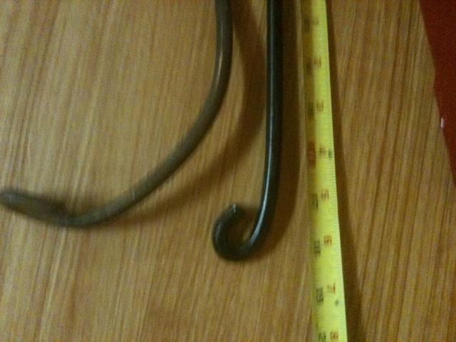

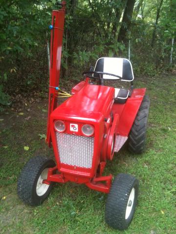

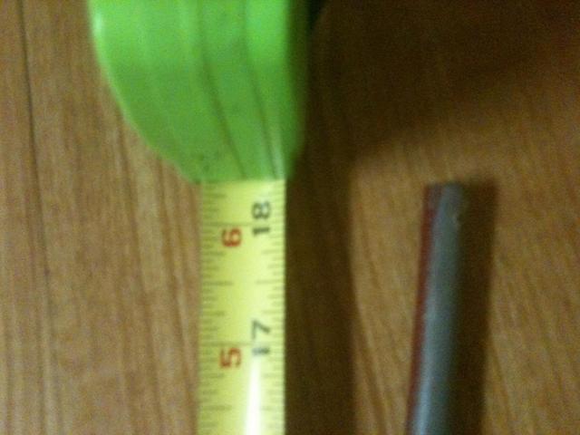

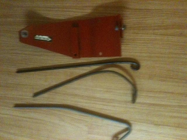

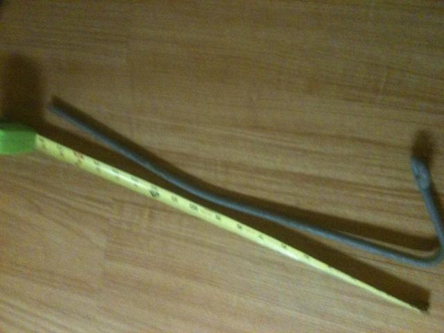

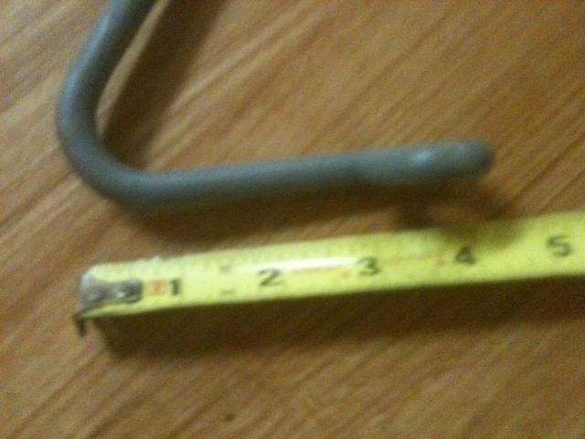

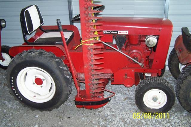

Lane Ranger 11,686 #4 Posted January 30, 2014 (edited) Looks good but you are missing a piece that goes on the part in front of the two side plates. The part that the belt makes the 90 degree (the one with the Wheel Horse Logo on it) turn had a cover over it. The two small sheet metal bolts look to still be in the part on top. Check your seals on this as they tend to leak especially after sitting unused for a long time. Great find! They are getting more rare every day! Also I have never seen the end piece like you have on this blade. It must be from another bar or homemade. Here is a photo of our 50 inch Wheel Horse Sickle Bar on a 1965 1054-A Tractor we own. Here is photo of the plastic guard I made to cover the blade when not in use and or when taking to a show. Also I went downstairs and took some photos for you of some weed guards (the heavy rod that is broken on yours that were on various sickle bars I have owned) to give you some ideas of measurements for your replacement. Should be an easy thing for a welder, machine or blacksmith shop to make up for you. The bar keeps weeds that don't get cut fully or just get caught in the bade from jamming it up. The rod is about 18 inches long by 4 inches with the round twist to bolt it on the bottom blade guard/foot closest to the tractor. Edited January 30, 2014 by Lane Ranger 2 Share this post Link to post Share on other sites

HorseWhisperer 243 #7 Posted January 30, 2014 I noticed the four small empty holes Lane but it looks like nothing was ever there.Well ya can't have it all Share this post Link to post Share on other sites

HorseWhisperer 243 #11 Posted January 30, 2014 Looks good but you are missing a piece that goes on the part in front of the two side plates. The part that the belt makes the 90 degree (the one with the Wheel Horse Logo on it) turn had a cover over it. The two small sheet metal bolts look to still be in the part on top. Check your seals on this as they tend to leak especially after sitting unused for a long time. Great find! They are getting more rare every day! Also I have never seen the end piece like you have on this blade. It must be from another bar or homemade. Here is a photo of our 50 inch Wheel Horse Sickle Bar on a 1965 1054-A Tractor we own. 101_0149.JPG The gather fin on the end is homemade but well done.I remember boards out there on older sickle bars.The gather hoop at the base is broke also but all in all I'm impressed with its overall condition.What year was this manufactured,early 60s ya think? 1 Share this post Link to post Share on other sites
HorseWhisperer 243 #12 Posted January 30, 2014 Wow Lane,I can't thank you enough.I was just sittin here scratching my head!Is that the cover pictured that I'm missing too? Share this post Link to post Share on other sites

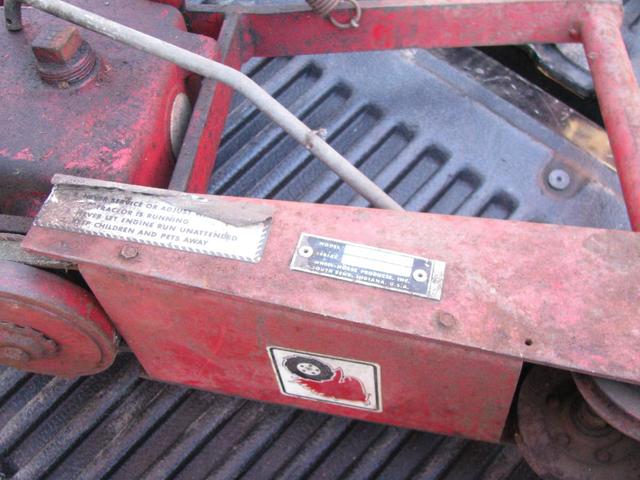

dclarke 4,113 #18 Posted January 30, 2014 Kevin, I think this is the belt cover that Lane is talking about. 2 Share this post Link to post Share on other sites

HorseWhisperer 243 #21 Posted January 30, 2014 Kevin, I think this is the belt cover that Lane is talking about. Denny,of all the pictures of the sms425 I haven't seen on of these covers!Thanks! 1 Share this post Link to post Share on other sites
