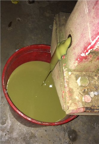

rodcogroup 3 #1 Posted January 27, 2014 I have an Ark loader on my C161. I have not used it in a while and took it out yesterday to move snow. The hydraulics were VERY slow. I expected that from the cold weather. I checked the fluid level and it came out milky (photo attached). I drained the fluid ( 10w-30 oil) and will refill it tomorrow. My question are: 1- Was the hydraulics slow because of the cold or because the fluid is contaminated? 2- Can I use a lighter oil in the system during the winter? 3- How did the oil get to be that contaminated? There are no leaks. Rob Pittsburgh, PA Share this post Link to post Share on other sites
daveoman1966 3,883 #2 Posted January 27, 2014 Hyd systems are sensitive to correct fluid levels, be it oil, ATF, or whatever. If the fluid is OVER-FILL, it will tend to foam, resulting in power failure. The fluid becomes impregnated with microscopic air bubbles and the only fix is to change the fluid. This is why, even on car automatics (which is just a complicated hyd pump), there is a warning "do not over-fill". From the looks of the fluid in your pic, this is exactly what has happened...the oil has turned to foam. Change the oil AND filter. Use the 10-30w or whatever is recommended and DO NOT overfill. It would behoove you to change the oil again after a few hours run time. Share this post Link to post Share on other sites
chazm 413 #3 Posted January 27, 2014 Taking your questions 1-2-3 #1 - Both will cause the hyds. to run slow #2 - You can use ATF or 10w year round #3 - Water got in thru the breather, fill cap or a crack in the reservoir tank Share this post Link to post Share on other sites

smoreau 658 #5 Posted January 27, 2014 Condensation in the tank will allow the water to get in. Drastic temperature changes will cause water vapor to cling to the inside of the tank and mix with the oil. Kind of like a ice cold drink on a hot summer day. You need to flush it out a few times and change it once a year to prevent it from happening again. This is why automotive manufactures want your your oil changed every 3000 miles or every 3 months, which ever comes first. This is to get contaminants like water out of the engine. Share this post Link to post Share on other sites
brandonozz 168 #6 Posted January 28, 2014 Any time a reservoir warms and cools the fluids inside will expand and contract bringing moisture in with each cycle. If the oil never gets warm enough (and long enough)to purge the moisture out it will collect over time. That would be my guess as to how the moisture got into the system. I heard the "car guys" on the radio having a discussion as to which is worse - driving a car for three minutes at a time or driving a car for 20 minutes at a time and they said that just using the car for short periods is the worst as the engine (and other fluids as well) will collect moisture each time it is used but won't ever get warm enough to purge the moisture. I've never actually checked to see how hot the oil gets on the loader when in use but it may not get hot enough to purge the moisture no matter how long you run it. Also, a low oil level would cause the oil to collect moisture quicker with each warm/cool cycle as the ullage is a larger volume bringing in more air each time. Share this post Link to post Share on other sites
rodcogroup 3 #7 Posted January 28, 2014 Thanks for the information. When I looked close I did see millions of tiny air bubbles. I have since drained the system, purged it a bit and refilled it. I will do again in the spring..its 4 below zero outside and I am done with any tractor work for a while. The filter idea looks doable..I will installthat in the Spring. Rob Share this post Link to post Share on other sites
