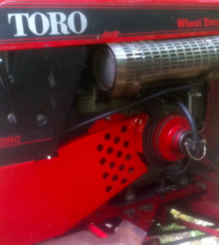

Navig8r 132 #1 Posted January 26, 2014 My 416 has about 500 hrs on it. It was my Grandfathers machine, and most of the hrs were with him running it... he always kept a small whisk-broom with him to brush grass off the intake, and would brush it off after mowing.... I helped with seasonal maintenance, and things were pretty much always put away clean. My uncle also used the machine a bit (10 hrs?) more recently, and I'm sure there was no maintenance with that usage. I have had it in storage for about 2+yrs,(It was running fine when I put it away) and plan to put it to work in the spring... mainly hauling firewood and dirt around my place, but possibly some mowing. I plan to clean everything thouroughly, change fluids, plugs, filters.... Any other suggestions? I have read here and on other sites of modding the belt cover to improve airflow to the rear cylinder... anyone have any pics? Thanks in advance for any help! ~T.J. Share this post Link to post Share on other sites

AMC RULES 37,255 #3 Posted January 26, 2014 Louvered belt guards are claimed to help airflow around the Onan rear cylinder. Member JayinNC has been making them in the past. Share this post Link to post Share on other sites

boovuc 1,090 #5 Posted January 27, 2014 After you take the engine tins off and make sure they are clean, buy an air tank and a cheap compressor. After doing anything with the machine and in particular, after mowing, blast air through the air shroud and around those tins to keep the grass from accumulating. This and a vented belt guard and keeping your oil changed are the best defense against overheating an Onan. Share this post Link to post Share on other sites
cheesegrader 434 #6 Posted February 3, 2014 Like this? These are 3/4 " holes. Most of the heat comes through the upper part of the vent. If you have a foot control pedal on that side, you might want to adjust the pattern to avoid a "hotfoot". Share this post Link to post Share on other sites
