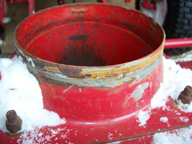

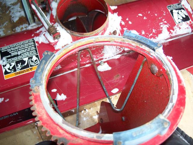

Kelly 1,037 #1 Posted January 25, 2014 Yep just what I said the tall shoot fell off the blower, as it did so I just staired out the window of the cab at it, then shut the blower down to go see WTF just happened, well there is a steel ring about 5/16" thick the shoot rides on, and at some point the welds broke and someone JB welded it back in place, I've owned the blower about 3 years now and never had a issue, but this is the first winter I have used it much, we have lots of snow this year, lucky for me I was done for the day, I need to tear it apart to fix it, but for now I have another tall shoot blower I will rob parts off, if they are the same it's for a XI series tractor, no pictures yet but I will get some when I go back out. Share this post Link to post Share on other sites

Kelly 1,037 #6 Posted January 25, 2014 I can fix what is broke, so no parts needed, but as I said for now I'm going to rob them off another blower, I have no idea how long the JB weld has been on it. Share this post Link to post Share on other sites

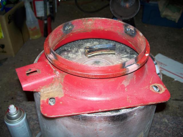

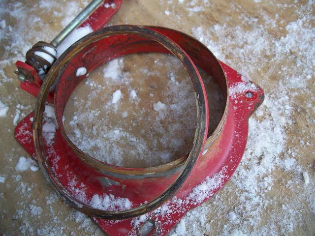

Kelly 1,037 #8 Posted January 26, 2014 Well I took a few to see what is what, and the XI parts will not fit, so I tore apart this one, I need to clean the JB weld off and drill some holes to weld the ring back on, the shop is warming up right now. More later 1 Share this post Link to post Share on other sites

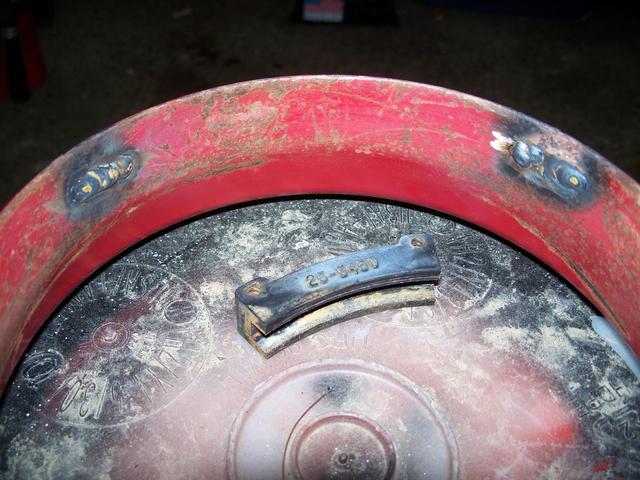

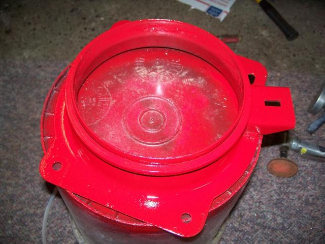

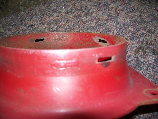

Kelly 1,037 #10 Posted January 26, 2014 I havn't used my blower this much in a few years. After getting the shop up to 40 deg. so I could work, I cleaned all the JB weld off, and then I drilled holes in line with the orig. welds then used a cut off wheel to connect the holes to make slots, I was not worried about being perfect just lined up so when I welded it would weld to the back of the ring, I also shot some red on the bare metal, I turned the heat on the welder up so it would burn in good, then after it cooled some I scuffed it all and shot some more red on everything, nothing fancy it's too cold to do a good job painting, just to help keep rust away, now let the paint dry and reassemble, not bad about a hour work time, not counting letting things warm up. Share this post Link to post Share on other sites

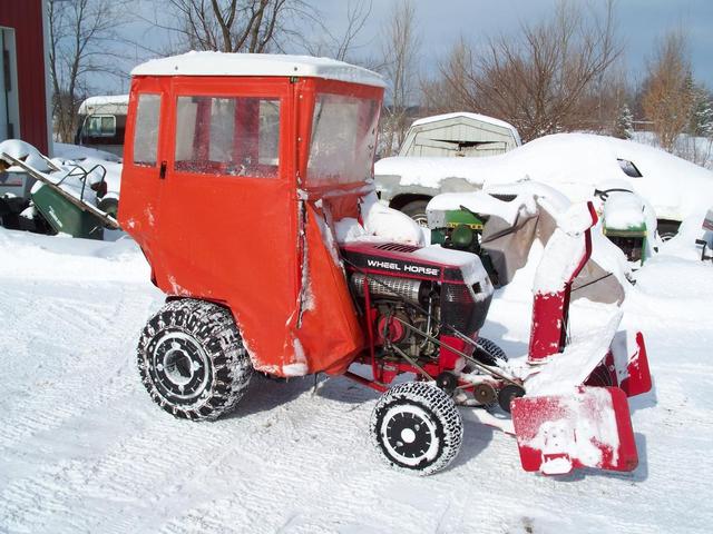

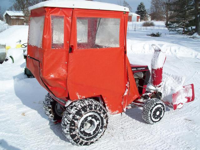

Kelly 1,037 #14 Posted February 2, 2014 Put the blower back together fri night and blew 8" of snow with it sat, and a final clean up of another 2-3" today still holding together, while it was down I built a extension for the turning handle, I built it 14" long so it is in the cab not in front of it, much better !!!!! 3 Share this post Link to post Share on other sites
AMC RULES 37,254 #15 Posted February 2, 2014 Looks like that is earning it's oats this year Kelly. Share this post Link to post Share on other sites
Kelly 1,037 #16 Posted February 2, 2014 This one sets all summer, I don't even take the blower off it, this is the most I have ever used this tractor. Share this post Link to post Share on other sites
