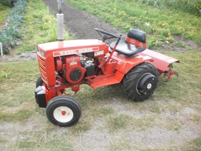

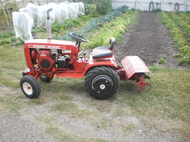

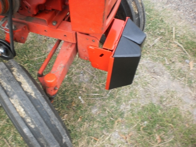

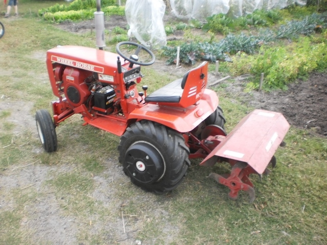

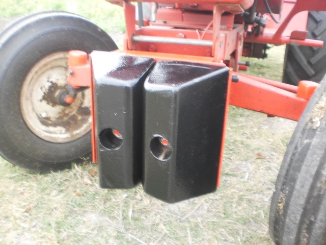

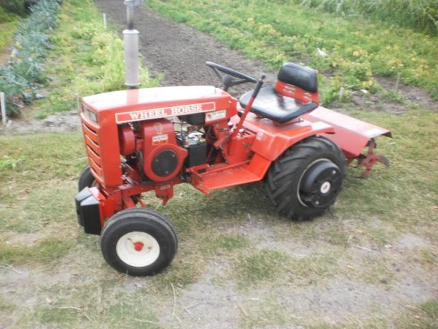

bowtiebutler956 650 #1 Posted January 23, 2014 I recently installed the tiller on my C-160, and with the tiller raised the front of the tractor was way to light. If I wasn't very careful releasing the clutch, it would do a wheelie, and drag the tiller on the ground. I have an old junk JD F510 that had some small weights on the back, and I figured anything from a John Deere makes good Dead Weight, right? Anyway, I had an extra mule drive laying around, so I made a few modifications to it, and bolted the weights on the front of the Horse. They snap right into the tach o matic, just like the mule drive does. Now, unless I just dump the clutch, the front end stays on the ground. Here are a couple pics, and yes they are from today. We're still gardening down here, although we're expecting temps close to freezing tonight, which is why we put bags over the tomato plants. This garden actually belongs to my good friend Byron, who is also a member here (byrunner). I help out with the equipment needs, and we're also tending it right now, as he is out of the country for a month. Matt 10 Share this post Link to post Share on other sites
AMC RULES 37,250 #2 Posted January 23, 2014 Looks good Matt, how much weight is it adding to the front? 1 Share this post Link to post Share on other sites

KC9KAS 4,744 #5 Posted January 24, 2014 They look like rubber baby buggie bumpers! Just kidding....they look nice. 1 Share this post Link to post Share on other sites
bowtiebutler956 650 #6 Posted January 24, 2014 Looks good Matt, how much weight is it adding to the front? Thanks Craig, and its not quite 40lbs, but very close. Nice job on the weights Matt But my question is.... why is it green there & not WHITE ???? Chazm, I live as far south as you can go in the US, the very bottom of . Its not unusual for us to go all the way thru winter without a freeze, and actually the grass is growing like crazy here right now. Its been making for plenty of seat time! bowtie, you allways do a nice clean job. looks good and serves a purpose. Glenn Thanks Glenn, I appreciate the kind words. They look like rubber baby buggie bumpers! Just kidding....they look nice. Actually, your right, they do kind of look like heavy duty rubber bumpers. Matt Share this post Link to post Share on other sites
