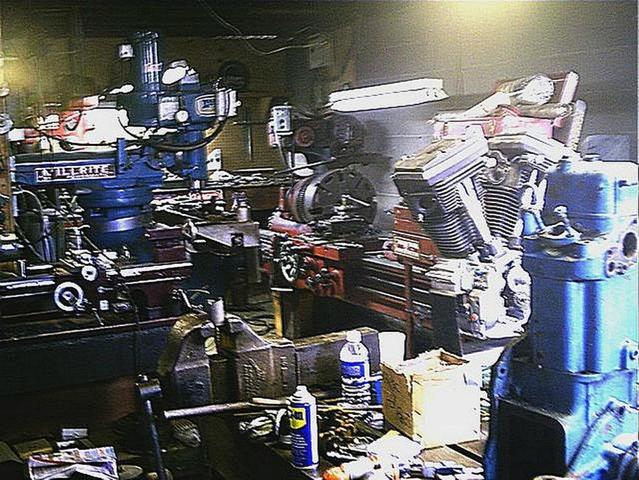

swarfeater 49 #28 Posted January 25, 2014 Must be a weight issue cause you fellas carry a lot more than i do, mines only got calcium front and back and this i did cause she had a hard time mowing around here. this is a lack of level land issue and even then she do's not like to turn when turning uphill. if it is a diff problem, that's going to have to wait a while, quite a while, i threw in a pic to show how much work room i have left in the shop, not much, got about 15 must complete projects in here already. Share this post Link to post Share on other sites

KC9KAS 4,746 #30 Posted January 25, 2014 (edited) Looks like you have a lot of machine shop tools in your garage. I hope you can determine what the problem is when you try to plow. Everyone on here is really proud of their working Wheel Horses. I think a lot of us take offense when someone has an issue with their horse and we try as much as possible to let it known what we do and how we do it to keep our horses working. We know what these machines can do and love to brag about them! Edited January 25, 2014 by KC9KAS 1 Share this post Link to post Share on other sites
boovuc 1,090 #31 Posted January 25, 2014 I'm sure you are experiancing more of a weight issue than anything! I see an Evolution sitting on the bench! And your in Pennsylvania? That isn't a priority! (Unless you or the owner of it is more hardcore a rider than I was)! Share this post Link to post Share on other sites

Forest Road 595 #33 Posted January 26, 2014 Sounds like you need some ballast. I run 200-400 lbs in here and have no problems moving a 2-stage blower in any direction. BTW - NICE SHOP!!!!! Share this post Link to post Share on other sites

swarfeater 49 #36 Posted January 27, 2014 the evo is mine, i just detuned it from 96 to 88 inches. i just turned 60 and kicking 96 at 10 to 1 is too much anymore. i suffer from no electric foot syndrome ! the other motor in view is a 1966 volvo penta diesel from my sailboat. parts from these are extinct, period, so rebuilding has been fun. i rebabbited the bearings and hammered them in, now i have to machine 2 jigs to machine them. next is a new piston, a friend has the old one at work to use the cmm they have there to give me a accurate blueprint. then i will machine a new one from bar. guess i could have thrown a modern motor in her, but she worked quite well for 48 years for me so i just could not break up the combo, and that single cyl putt putt(6hp)is a lovely sound. luckily there is a company in texas that makes piston rings that will fit about anything with a bore from 1.5 inch up to 12 inches, so that was easy. a far as the horse go's, the tires are stock lawn treads with calcium and chains in the rear, not a good snow combo i understand, but should be better than it is, i will look for a differential problem as suggested when i get a chance, and thanks to those who pointed me that way. Share this post Link to post Share on other sites
