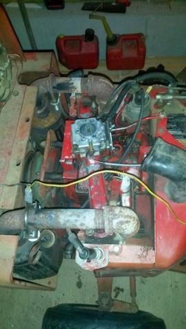

1977.d-160 1 #1 Posted January 22, 2014 Last storm I was using my D160 to plow the snow. It was doing a great job until I ran out of gas. Once refueled it took a bit to get started as is normal/expected. It ran ok for about 5 minutes then started bogging & stalled. It would restart, then sputter out when under load of the hydro trans. Then it stalled again & wouldn't restart. I let it sit for an hour & charged the battery. It started again, but wouldn't drive & eventually failed to stay running. I pulled apart the fuel pump and gave it a good squirt w/ carb cleaner while cranking for a few seconds & reassembled. New fuel filter too. Fuel is squirting (more like running/steady dribble) from elec fuel pump. Also pulled the diaphragm off the side of the carb & squirted. Dry-gas didn't work so I siphoned virtually all gas & debris from fuel tank. Screen strainer in tank looks fine, but I did give the gas line a shot w/ the air nozzle. 1/2 tank of fresh gas... I generally use fuel stabilizer, but nothing in this fresh gas. Oil level is OK Fuel lines OK Choke & throttle linkages are OK. Cracked open the fuel to ensure no vacuum I wanted to pull the carb, but the intake manifold is under the exhaust pipes and I can't get it out. I was able to unscrew a dowel to free up one side. I can't get the other and the exhaust pipe wasn't budging. While in there I hit the points lightly w/ some abrasive paper (they don't look great, but seem ok). I put that all back together & settled for pulling the top (bowl) of the carb off & spraying it. Now it runs w/ starting fluid, but it won't stay running on its own... I'm wondering where to go from here... I'm thinking if I can get a carb rebuild kit (gaskets/jets) I'll get a cheater bar on the pipe wrench & get that dang exhaust pipe & manifold off somehow. Pipes are rusted tight. They seem solid enough to get some force on them. Where can I get a carb rebuild kit? Think that's it?? I've already read this link: Sorry so wordy... Looking fwd to the groups help (again). Share this post Link to post Share on other sites

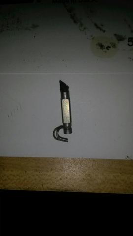

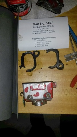

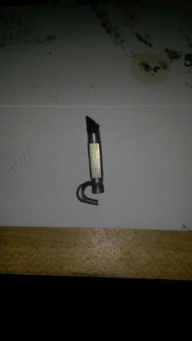

1977.d-160 1 #8 Posted January 23, 2014 Thanks for all the feedback! Here's what I did today: 1) Siphoned tank dry & got some more detritus out of the tank (it's fairly clean inside). 2) Followed suggestions to remove the petcock/fuel shutoff & clean it. It looked & flowed ok to begin with but I sprayed it for good measure. 3) Shot of air in fuel line at fuel pump back through fuel filter & into a bucket where it connects to the tank. Gas looked fine, no hose parts or junk in it. 4) Disassembled & cleaned fuel pump. There was crud build-up behind the diaphragm where the spring goes. 5) Reassembled everything, purged air from fuel line before testing pump - pump seems OK. Won't fire unless I squirt it w/ ether. I ran it that way for about 20 seconds to give fuel a chance to get back into carb. Still won't run on its own. I used the energy from my frustration to get the exhaust pipe free. Then I proceeded to pull the carb & clean it. The crown on the valve that rides above the floats is 'off kilter' in that if it were a hat it would be put on crooked. It doesn't look like any I've seen before - normally they're straight. Is that normal? Where can I get a new one? Intake manifold gaskets are shot (see picture). I picked up high heat engine silicone and a roll of gasket material (on left of img / description at top of pic). Can I get gaskets made for this? Should I try cutting my own gaskets w/ this stuff? It's thinner than what was on there by 1/2 or 1/3 as much. Should I double it up? Isn't that generally a bad idea? Should I use the high heat silicone? I lost count of the air to fuel screws. There's two, I assume one for low rpm & one for high. I don't know which is which or what they should be set to. I think one was ~2 1/4 turns out. Lost count on the other when a buddy stopped by, but it seemed like 3 or 4 turns in until it bottomed out... Thanks again everyone Share this post Link to post Share on other sites
Desko 634 #9 Posted January 23, 2014 Its best to buy new gaskets in my opinion they sell the gaskets on eBay around $14 free shipping. What do you mean by "off kilter"- crooked all I could guess is you are talking about the needle valve. Share this post Link to post Share on other sites
1977.d-160 1 #10 Posted January 23, 2014 I looked on ebay, but am not sure which are the correct intake gaskets. Can anyone send a link? Definitely looks like the float needle is junk. Where can I find a new needle? PartsTree shows Toro Consumer 201210 is available through some Wheel Horse Distribution Network - whatever that is... Can bring it to tractor supply or napa and match it up to one? There's a motor cycle shop down the rd - maybe they'll have something?? Anyone know the settings for the mixture screws on the carb? I'm kicking myself for not paying closer attention to them. Share this post Link to post Share on other sites

WH nut 553 #12 Posted January 23, 2014 To make your own gaskets what I use is the cardboard from something like a filter box. Try to find something without all the shinny printing on it, but that thickness of cardboard. Lay over the manifold and talk a small ball pen hammer and tap out. Share this post Link to post Share on other sites

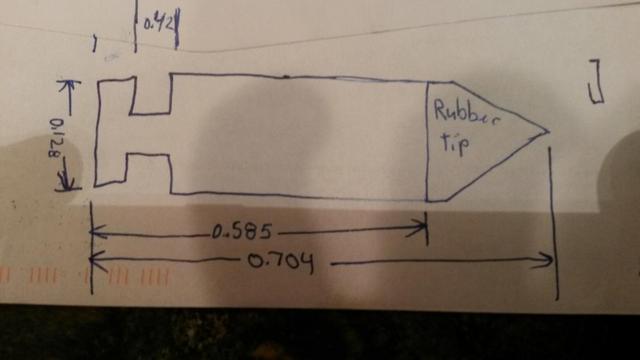

1977.d-160 1 #13 Posted January 24, 2014 Img attached is a sketch of the jet I'm looking for in case anyone knows where I can get one... Precision isn't actually to .001" accuracy! If I can't find intake gaskets, I'll probably try rolling my own w/ the gasket material I picked up. Should I double-layer them or not?? Anyone know how to set the carb's mixture screws? Thanks again Share this post Link to post Share on other sites
