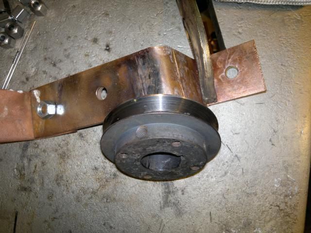

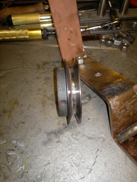

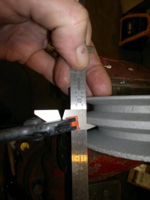

Sarge 3,470 #7 Posted January 28, 2014 Ok , first - these pulleys are not cast iron - they are indeed cast steel as I thought , so highly weldable . Used 308L filler rod to build up the badly worn area and re-cut the angle on the lathe . http://i479.photobucket.com/albums/rr159/morepowr/1277pulleyweld.jpg http://i479.photobucket.com/albums/rr159/morepowr/1277pulleyweld2.jpg http://i479.photobucket.com/albums/rr159/morepowr/1277pulleyweld3.jpg Last photo shows the angle these are cut stock - 35* which is a bit odd . Anyhow , tractor has way more hydro power now and belt is tracking great - we'll see how well it lasts . http://i479.photobucket.com/albums/rr159/morepowr/treesmile.jpg Sarge 1 Share this post Link to post Share on other sites
sorekiwi 761 #8 Posted January 28, 2014 Interesting post Sarge. I cant say that I have ever looked that closely at the grooves on the pulleys on my 1276, I will when that tractor gets unburied from the back of the shed. I guess I never heard about the problems of running A belts instead of HA belts before. What is the issue? Both are supposedly a 40 degree angle on the section, and it seems that the dimensions are the same. Interesting that the stock angle on the pulley is 35 degrees, I wonder if they did that to allow for some wear? Share this post Link to post Share on other sites
Sarge 3,470 #9 Posted February 4, 2014 I believe the pulley angle is directly intended to help with de-clutching the hyrdo when in park , otherwise it would create excessive wear in the belt . There are subtle differences in belts , HA cut belts have a slightly different profile making them wedge into the pulley differently . In my opinion , the wear on the pulley is not just from age - it's from using A belts over the years or at least that has to be a contributor . I had an hour long talk with one of the techs from Q-Power over all this - he said they can actually make an HA cut belt with no cover so that is an option although I'd bet it won't be cheap . For now , no belt wear showing and the pulley still looks new . Sarge 1 Share this post Link to post Share on other sites
