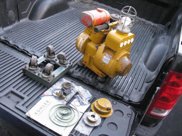

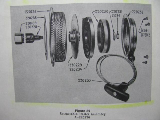

AMC RULES 37,250 #1 Posted January 21, 2014 Any parts available for an early Schnacke (K-90) recoil? I'm looking to find a suitable replacement for the pull cable, and recoil spring used on this unit. Any help would be greatly appreciated. Share this post Link to post Share on other sites

AMC RULES 37,250 #9 Posted January 22, 2014 It came to in pieces, disassembled by the PO. Seemed to me pretty straight forward to reassemble...no problems there. Checked the parts diagram in the gen set manual, seems like it went back together correctly. Rebuilt my other Fairbanks Morse recoil this past summer using a $2 Tecumseh replacement recoil spring from Ebay...worked like a charm. Seems to me like something with similar ends on it would work well in this application too. I'm thinking two dollars...I'll roll the dice, and take another chance. 2 Share this post Link to post Share on other sites

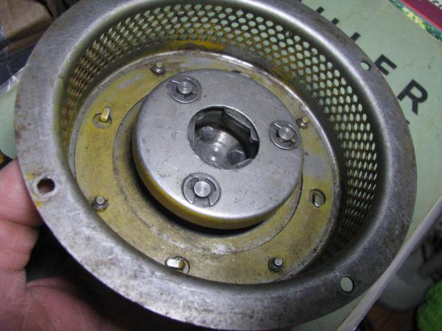

AMC RULES 37,250 #11 Posted January 23, 2014 Were the internal of these all the same...or are there a couple different models out there? I found some online picts where the dog cup looks different than mine. Share this post Link to post Share on other sites

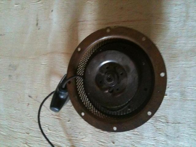

dclarke 4,113 #12 Posted January 23, 2014 This is what's on my K91, Craig. Looks like there's at least two different models. This is what it looks like when I pull the cable. And this is the nut 2 Share this post Link to post Share on other sites
AMC RULES 37,250 #13 Posted January 23, 2014 for sharing the picts Denny. Yep, yours looks the same as mine...what size is the nut? Seems to be the only piece I'm missing. Share this post Link to post Share on other sites
dclarke 4,113 #14 Posted January 23, 2014 The nut's 7/16" S.A.E. thread. Share this post Link to post Share on other sites
AMC RULES 37,250 #15 Posted January 23, 2014 Perfect, I need one of those. Thank you Denny. Share this post Link to post Share on other sites

AMC RULES 37,250 #18 Posted January 24, 2014 I thought something was up with these units...being that the Kohler manual parts diagram I included in the initial post here shows a two piece drive nut setup. I didn't think that would end up being the correct drive for this unit...which is why I asked if there were more than one version of the Schnacke recoil out there. I'm hoping someone can post here the part number for the correct inch and a half drive nut I'm now searching for? Share this post Link to post Share on other sites
TT-(Moderator) 1,169 #19 Posted January 24, 2014 https://www.partstree.com/parts/?lc=kohler_engines&mn=K91-2739++%284+HP+%283+kW%29+SPECS+2650-31997%29&dn=catalogs_11088 1 Share this post Link to post Share on other sites
AMC RULES 37,250 #20 Posted January 24, 2014 Ahh...there you go...thanks Terry. 1 Share this post Link to post Share on other sites
