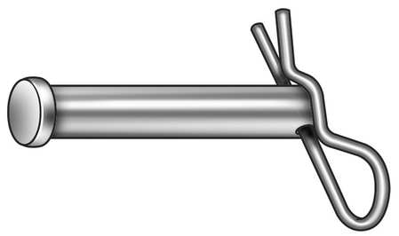

TT-(Moderator) 1,162 #3 Posted January 18, 2014 You might be able use a custom-built long clevis pin / hairpin clip. Example: ......or you could use a rod with a hole at each end for a hairpin clip. Share this post Link to post Share on other sites
