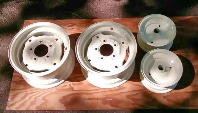

rmaynard 17,458 #52 Posted June 2, 2014 Some days I feel like going back to bed. Today is one of those. I spend all day Saturday wire brushing, and sanding my wheels. I might have mentioned that my powder coater went out of business, and my neighbor's sand blaster is not available at the moment, so it's manual labor for me. After they were done, I shot a quick coat of epoxy primer on them. Then Sunday I devoted 4 hours to painting the wheels with several rattle cans of Gloss Ivory from our friends at Krylon. They looked great last night when I put them in the garage. I gave them plenty of time to dry. Then, this morning I gave them one more coat for good measure, and came back 10 minutes later only to find that the paint had lifted and crinkled over 50% of the surface. Note to self --- you had trouble with Krylon before, STOP USING THE STUFF. Okay, I feel better now. So after baking them in the wife's oven for about and hour, I sanded them smooth again, then repainted with Rustoleum Appliance Epoxy (color bisque). They are back in the oven again. Wife gets home at 5:00 pm and I've got to get this smell out of the house. 3 Share this post Link to post Share on other sites
squonk 47,476 #53 Posted June 2, 2014 I've seen Rustoleum do that to as well as other enamels. Rusty says, "apply additional coats within an hour or after 48 hrs." Another brand whose name escapes me says 'If additional coats are needed wait 48 hrs' to prevent a re-coat lift". I would say that's what happened to your wheels. I painted my trailer and toolbox for it with Rusty oleum. I missed a small spot on the box and the next day when I saw it I shot it quick and yes it wrinkled. Share this post Link to post Share on other sites
rmaynard 17,458 #54 Posted June 2, 2014 I'm sure that's what happened as well. The Krylon instructions were to apply second coat within 1 hour or after 24. I guess 23 hours is just not long enough. Give me a break. Remember when Johnny Bench used to advertise for Krylon? "No runs, no drips, no errors". Where's Johnny now? Oh, he's doing commercials for Blue Emu pain rub. Share this post Link to post Share on other sites

Racinbob 13,054 #58 Posted June 3, 2014 Follow-up: The wife got home at 5:15. The kitchen was clean, dinner was on the table, and the only odor left in the house was that of the barbecued chicken breast fresh in from the grill. Nice save!! I've had better luck with Krylon when it comes to the paint wrinkling but I think Rustoleum gives a better finish. I now try to plan things so I can let either brand dry for a much longer time than the can says. 1 Share this post Link to post Share on other sites

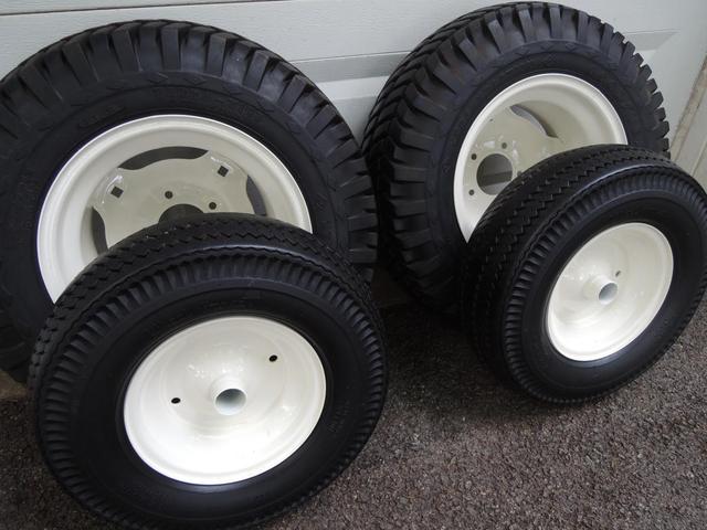

rmaynard 17,458 #59 Posted June 4, 2014 Trouble is the weather has been so darned uncooperative this year that I don't have much of a window of opportunity to paint. Considering that I paint in the driveway, I am subject to hot, cold, wind, rain, pollen, leaves, neighbor cutting grass and raising dust, etc. So with that said, I finally got the wheels done, tires cleaned and mounted. 3 Share this post Link to post Share on other sites
Mr. 856 170 #60 Posted June 6, 2014 they look awesome. any issues with chipping paint when mounting the tires? Share this post Link to post Share on other sites
Martin 2,134 #61 Posted June 6, 2014 Very very nice Bob. you just can't beat the look of original tires...... the wheels came out looking real nice. Share this post Link to post Share on other sites
AMC RULES 37,259 #62 Posted June 6, 2014 So...if you don't have time to do it right, when will you have time to do it over? The world may never know. Share this post Link to post Share on other sites
rmaynard 17,458 #63 Posted June 6, 2014 they look awesome. any issues with chipping paint when mounting the tires? Just a few. I always mount the tires so that the marks if any are on the inside. A little touch-up with a small brush takes care of that. Sent from my Moto G using Tapatalk 1 Share this post Link to post Share on other sites

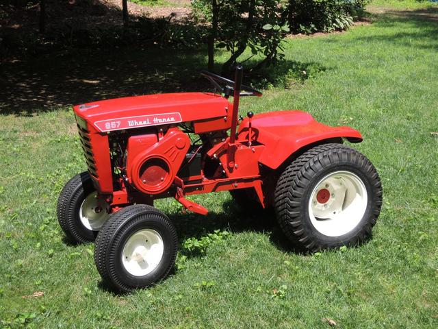

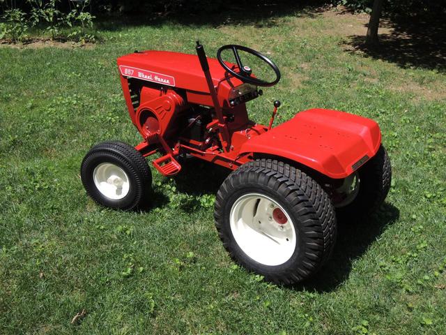

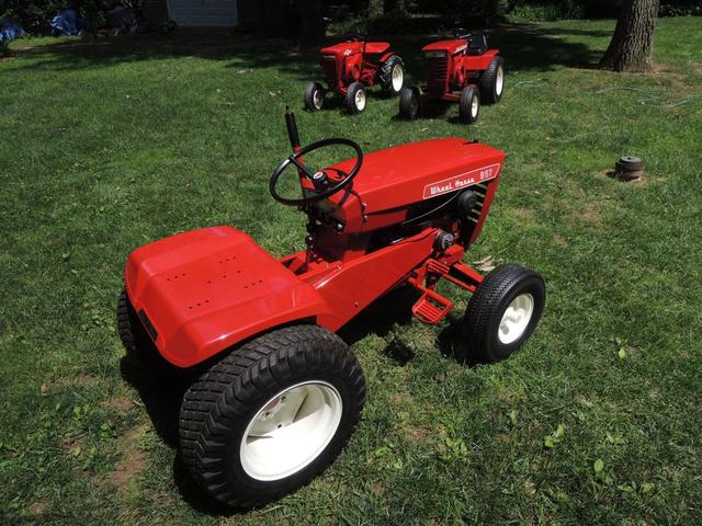

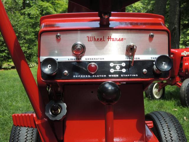

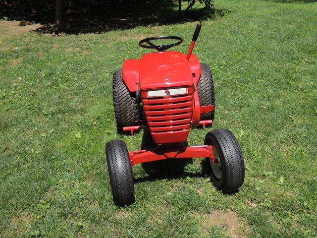

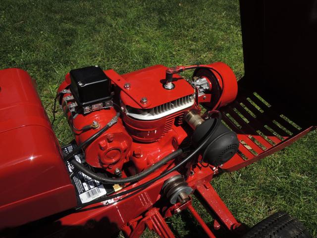

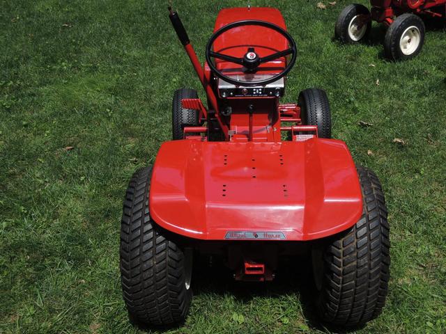

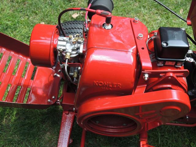

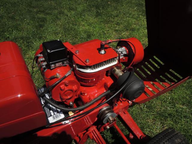

rmaynard 17,458 #68 Posted June 16, 2014 Well...with a beautiful weekend behind me, and another beautiful day today. I actually think I may have this one ready for the show. I painted the belt cover, fender pan, and hood Saturday and Sunday. Both the belt cover and fender got dust in the paint, so I hand-worked them with 2000 grit paper and compound and they turned out nice. That's the good thing about using an acrylic paint. It's hard enough to sand and polish in less than 12 hours. On Sunday, I painted the hood. Put two coats on and came back to find a family of gnats doing the back stroke down the middle of the hood. So I got my tweezers and gently removed them, sprayed a third and final coat, ran the hood into the garage where I was hoping to keep it out of harms way, but no. Check on it last night and at lease four more gnats had found their way into the back of the garage, only to land on the hood. So this morning, I carefully picked them out and spent 3 hours wet sanding with 1000, 1500, and 2000 grit sandpaper, followed by an hour of compounding. Anyway, I guess all is right with the Wheel Horse gods as I am proud to present these pictures. Couple of other items of note. I rebuilt the engine back during the winter, but never had a chance to start it and see if it ran. So last Thursday, with 3 of 4 grandsons standing with fingers in ears, I cranked it over, it started immediately, and ran like it was brand new. No smoke, and only a small tweak of the main jet. As you can see, there is no seat. Dave Burley (Funengineer) sent me some custom-made two-piece seat covers, so tonight while relaxing in the recliner I will finish assembling them. But otherwise, it looks like a go for Thursdays journey. 6 Share this post Link to post Share on other sites
Fun Engineer 863 #69 Posted June 16, 2014 Can't wait to see your latest resto Bob. Pictures look great. Sent from my tractor seat using Tapatalk 2 Share this post Link to post Share on other sites
JERSEYHAWG / Glenn 4,580 #70 Posted June 16, 2014 BOB. Looks A+ to me. Job well done. Glenn Share this post Link to post Share on other sites
Martin 2,134 #71 Posted June 16, 2014 another very nice restoration, Bob!!!!! Share this post Link to post Share on other sites
squonk 47,476 #72 Posted June 16, 2014 Get job Bob! The tractor I'm bringing is the polar opposite. Paint on the hood is so thin it only has one side! But it's original Share this post Link to post Share on other sites
Racinbob 13,054 #73 Posted June 16, 2014 Incredible job Bob. Please post more pics when you get the seat on. Share this post Link to post Share on other sites
rmaynard 17,458 #74 Posted June 16, 2014 Incredible job Bob. Please post more pics when you get the seat on. I will do that. Share this post Link to post Share on other sites
