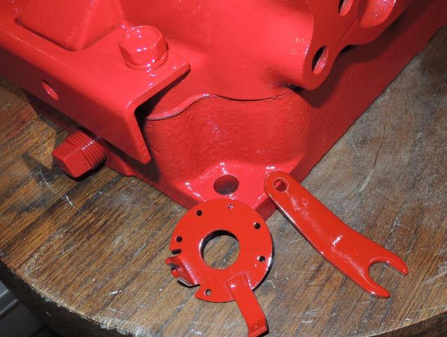

rmaynard 16,896 #27 Posted March 10, 2014 (edited) Looks good Bob. What paint did you use? Jack, I used something that I thought I would never use. TSC was having a sale on their Majic Red Oxide primer, so I bought a can. Then on a whim, I bought two rattle cans of Majic IH Red paint. That is what I used. It's been sitting now for 8 hours and the darned stuff is still tacky. Also, I haven't checked to see how the color matches up with the old Valspar Restoration Series IH Red, but I will. I painted the external governor parts with that back when I disassembled it, and as soon as I find them, I will do a color comparison. Okay, I found the parts that were painted with VRS IH Red. To my eye there is no comparison. Edited March 10, 2014 by rmaynard 1 Share this post Link to post Share on other sites
Wishin4a416 2,473 #28 Posted March 11, 2014 I see what you mean Bob. The one is a lot deeper color. Share this post Link to post Share on other sites

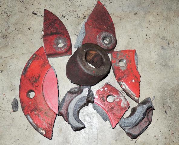

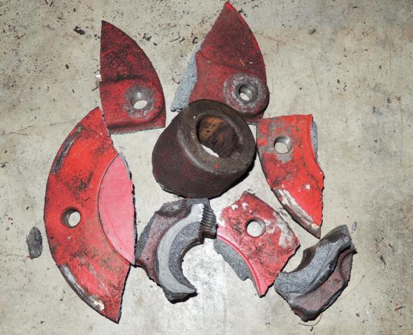

rmaynard 16,896 #44 Posted April 20, 2014 Update. I finally got back to the 857 this weekend. I have stripped the Majic paint off of the engine and it is ready for some real paint. I purchased some Van Sickle IH red, but I don't like the color, or the fact that it is an alkyd enamel. I thought I was getting acrylic enamel, but I failed to be specific when ordering, so my bad. If you are interested, it is in the classified section and on eBay. Anyway, today I power washed the frame and then decided to replace all the seals in the transmission. There was an extreme amount of oil and dirt and grass caked to the bottom of the tranny, and only about a quart of oil drained out, so I figured there must be a leaky seal. So, I got out the hub puller and started to remove the left hub which I suspected had the bad seal. Now usually the hub that has a bad seal behind it come off fairly easily, but nooooo. This one fought me until it broke. So, now with 1/3 of the hub broken off, the puller became worthless. It took 2 hours or sawzall and chisel work to bust the rest of this little baby off. The right side was also tough, but came off in one piece. No leaky seal found, and now I need a good 4996 hub. Monday I will remove the brake drum and input pulley. Back to the paint situation. Since this one is going to be my "toy" and not a show queen, I have finally decided to paint it with PPG Shop-Line acrylic enamel. This paint has much better coverage than the urethane, and at only $33.00/qt. it's a lot more economical. Picking it up on Monday, and if the weather stays nice for a while, I might even get the frame, transmission and engine painted this week. More to follow. Should have some pictures in the next update. 3 Share this post Link to post Share on other sites
AMC RULES 37,254 #45 Posted April 20, 2014 (edited) You do nice work Bob... only two hours to make that awesome puzzle. Great 50/50 prize for the big show. Edited April 20, 2014 by AMC RULES Share this post Link to post Share on other sites
