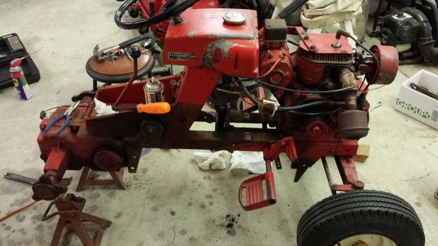

JERSEYHAWG / Glenn 4,498 #1 Posted January 14, 2014 Gents. I started to tear down the 864 for restoration. Everything was breaking down fine till trying to get the steering wheel off. I am assuming it's down on a splined shaft. Can't get it to budge. Any ideas from those that have done this. Trying NOT TO ruin the wheel. Thanks a million. Glenn Share this post Link to post Share on other sites

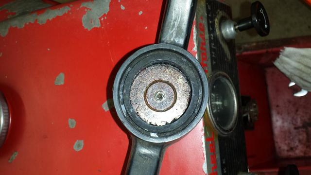

JERSEYHAWG / Glenn 4,498 #4 Posted January 14, 2014 (edited) I am soaking the top and shaft with pb blaster. In a while I will get a punch and tap the top. Try to shock it. Maybe a ton of crude has it glued on, not sure, being delicate. not using any heat yet. thanks Bob. Glenn MOD OR ADMIN: made a mistake in title,,,its my 1964,,854. typo,,please change. ty Edited January 14, 2014 by JERSEYHAWG / Glenn Share this post Link to post Share on other sites

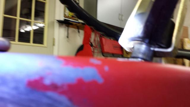

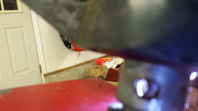

JERSEYHAWG / Glenn 4,498 #7 Posted January 14, 2014 This is a picture. Looking through the shaft and hole where there is no pin. Holding a small flashlight on the other side. Glenn Also. You can see the wheel is offset bout mid point of where pin would go. Glenn Share this post Link to post Share on other sites

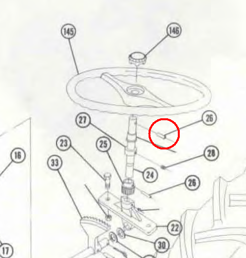

rmaynard 16,289 #10 Posted January 14, 2014 Looks like the pin has already been removed. Now you need to get a good puller, hook it under that bottom steel portion of the steering wheel, and pull it off. Keep loading it up with PB Blaster. Punching the top of the shaft will only spread it out making it harder to remove. Worst case scenario, cut the shaft off below the wheel, then put the wheel on an open vise and punch the remaining part of the shaft out. A replacement steering shaft should not be hard to find. Share this post Link to post Share on other sites

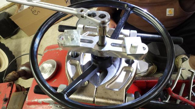

JERSEYHAWG / Glenn 4,498 #12 Posted January 15, 2014 (edited) Terry, I am going to give your idea a whirl. I tried 3 sized wheel pullers. no go. Fankly if you fellas saw the size of the bearing splitter my brother and I put okn that steering wheel shaft tonight you would laugh. I am telling you this thing is huge. Just dont have the H clip big enough for it. I also am worried about breaking that darn 50 year old steering wheel. Frankly was looking into buying a new bearing seperator kit. They can be used for stuff like this. Thanks for the idea, will keep you posted. Glenn Edited January 15, 2014 by JERSEYHAWG / Glenn Share this post Link to post Share on other sites

JERSEYHAWG / Glenn 4,498 #18 Posted January 15, 2014 Let's see. Glenn 1 Share this post Link to post Share on other sites
rmaynard 16,289 #19 Posted January 15, 2014 Yup, that'll do the trick. Share this post Link to post Share on other sites
AMC RULES 37,195 #20 Posted January 15, 2014 ...or destroy it. Share this post Link to post Share on other sites
JERSEYHAWG / Glenn 4,498 #21 Posted January 16, 2014 That is under the metal sleeve of the steering wheel. Can't get it to pop. Taking a breather. Can't figure what's holding it. Back to the drawing board. It's a real stinker. Glenn Share this post Link to post Share on other sites
