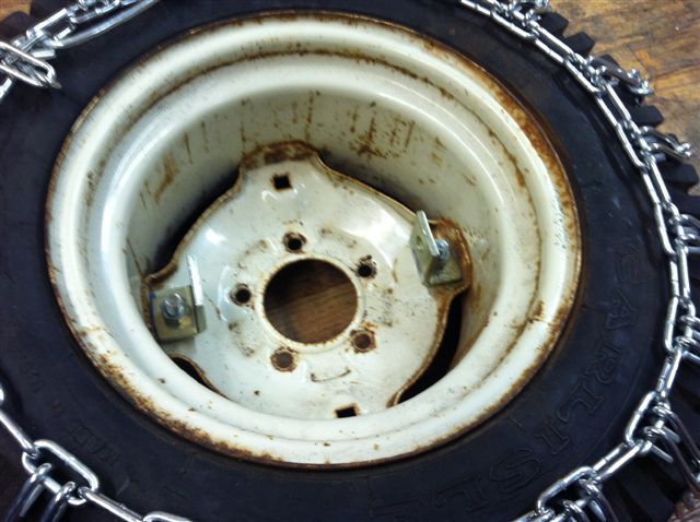

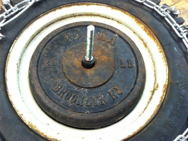

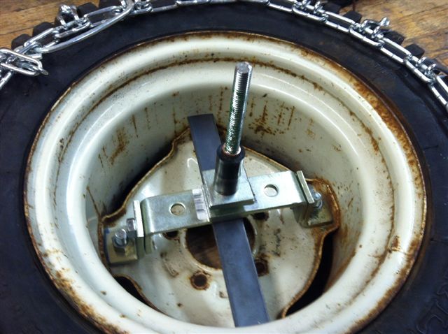

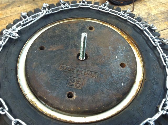

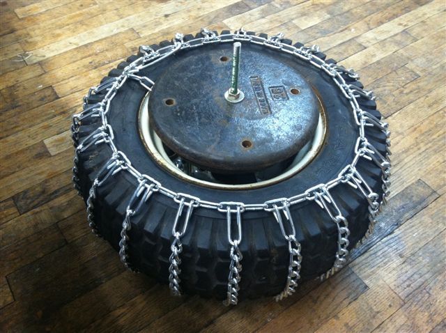

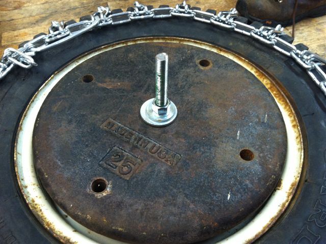

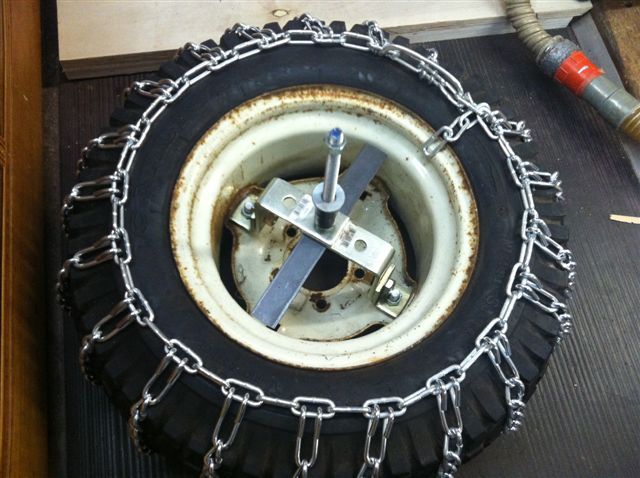

formariz 12,354 #1 Posted January 12, 2014 Since the weights are usually found free around here, and I did not want to pay the $80.00 for a special bracket available on eBay I came up with my own design made up from strut brackets easily available at Home Depot for about $10.00 per wheel. It also works out that these are easily removable in order to remove wheel since one can remove it from front. 3 Share this post Link to post Share on other sites
Sparky-(Admin) 24,657 #2 Posted January 12, 2014 Looks like it would work well. My only complaint would be how far out they will protrude from the rim. Mike......... Share this post Link to post Share on other sites
varosd 1,185 #3 Posted January 12, 2014 Formariz, Can post some pictures of the back side of the bracket? Can you adjust the threaded rod portion so if you only have 1 plate on it won't stick out like a chariot from Ben Hur? 1 Share this post Link to post Share on other sites
formariz 12,354 #4 Posted January 12, 2014 right now it has 2 25lbs weights on it. bracket can be adjusted so if you have smaller weights they fit inside of wheel.Bracket can me made to go another 2 inches into wheel. threaded rod will of course be cut once one decides how many weights to keep on it. Share this post Link to post Share on other sites

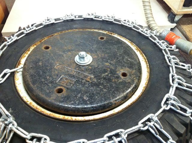

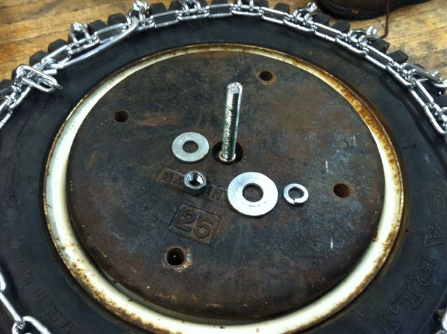

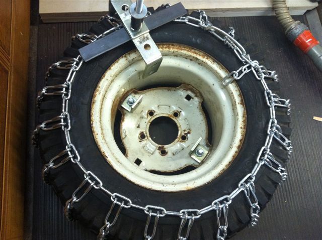

formariz 12,354 #6 Posted January 14, 2014 Here they are completed . 50lbs per wheel at less than $20.00 total. 1 Share this post Link to post Share on other sites
The Walri 4 #8 Posted January 18, 2014 Very clean I like it! Sent from my SCH-I545 using Tapatalk Share this post Link to post Share on other sites
