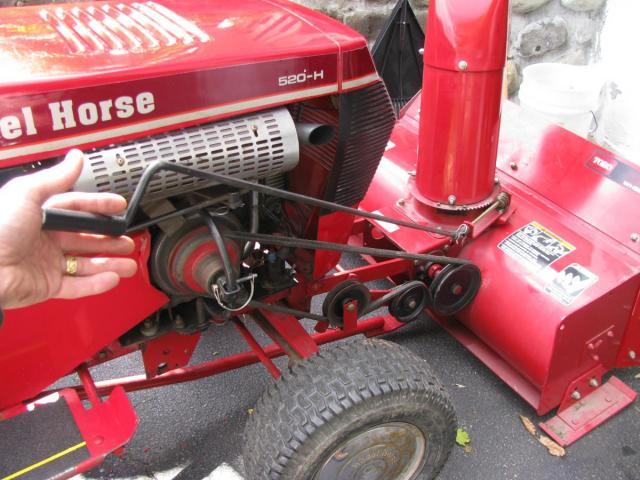

cleat 8,103 #10 Posted January 14, 2014 Wider shoes are good as long as they don't stick out too far and hit things on the edge of your driveway. On my old Ford LGT 2 stage I widened the shoes towards the inside. Also make sure your springs are in place to take most of the weight of the blower. My old ford and my current Wheel horse 520H both with the 2 stage I can easily lift the blower from the front with one hand. Less down pressure means less digging in. Share this post Link to post Share on other sites
