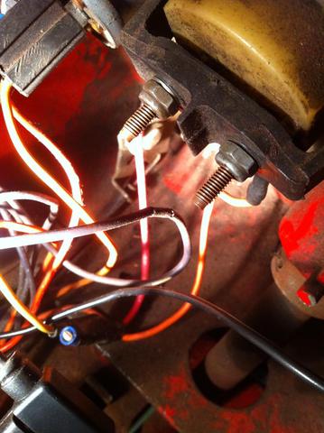

squonk 47,679 #38 Posted January 12, 2014 (edited) Progress. Ran a jumper to the coil from the battery and ran it for about 3 min. Ran fine outside of a little carb adjustment. Pulled the jumper and it started acting up in about 10 seconds. Started following the wire back and found this. The looped black wire out of the switch is 12 v to the PTO switch and has cracks in it. There it's a double terminal and continues on to the coil. I'm going to run a new wire in the next few days and if it continues, replace the switch. Edited January 12, 2014 by squonk 3 Share this post Link to post Share on other sites

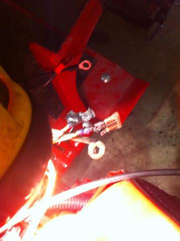

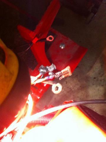

squonk 47,679 #46 Posted January 13, 2014 Marvin's problem has been found! I replaced the wire from the switch to the coil. Problem was still there. Next I replaced the switch with a new one. I originally got the switch for my C-160 as it is worn and the key falls out. Haven't gotten to it yet. Anyway Problem is still there. Next I replaced the points as the gap is too narrow and the contacts are oxidized. Problem is still there. So now I put my voltmeter on the coil and battery positive and I'm dropping 2 volts with the key on. Start it and now I'm dropping 4 volts with it running good and 6 volts when it starts to misfire. Now I trace the wire from the solenoid to the ammeter. I unwind the crappy tape and find even worse tape. Unwrap and find this. Some Gibronie decided to put an inline fuse in there and did a lousy job. I cut it out and twisted the wires together to try it and VROOM!!!!!!!!! Funny thing I was planning on going thru the wiring in the spring! 1 Share this post Link to post Share on other sites
