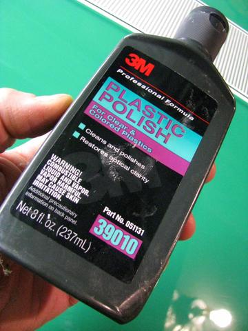

AMC RULES 37,192 #2 Posted January 11, 2014 This stuff will make it glow. 1 Share this post Link to post Share on other sites
dodgemike 52 #3 Posted January 11, 2014 I know Meguirs and Mothers Make similar products. You can't Go wrong with 3M. It is not cheap But.....you get what you pay for. Sent from my SCH-S720C using Tapatalk 2 Share this post Link to post Share on other sites

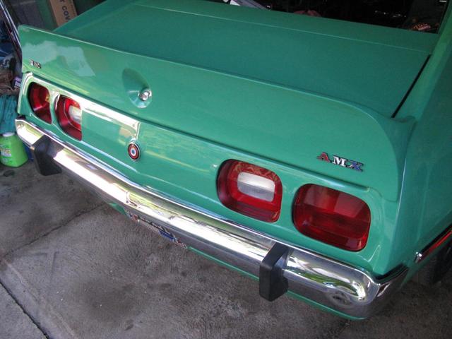

AMC RULES 37,192 #7 Posted January 11, 2014 I used it on my snow cab windows because of it's advertised "restores optical clarity" claim... using a micro fiber cloth, I applied it liberally, and with using very little elbow grease... the before and after difference was remarkable...so much clearer from just the one application. Had originally bought the product back when I was restoring the taillights on my Javelin, that was 2009... they're still glowing like brand new. You might pay a little more for the 3M name, but you can't argue with the results. 1 Share this post Link to post Share on other sites

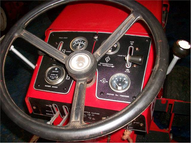

wheeledhorseman 579 #8 Posted January 11, 2014 Here's what the wheel on my D-200 looked like before cleaning up. The discoloration is actually mainly due to a build up of finger grease over the years - yuk! I've found that for the best results it's important to remove this stuff before using the sorts of products already mentioned and for this I've found that strong spray kitchen detergent (the stuff for greasy surfaces) does the job if applied neat and brushed in with a stiff toothbrush. It can take several attempts to get rid of it completely. Once it was gone, and as this was a 'soft touch' wheel I used a 'dashboard clean and shine' product for automobiles in that it doesn't leave any residue in the same crevices you've just cleaned out. Smooth hard plastic type steering wheels are suited to the use of midly abrasive products for the shining up process as already mentioned. Just my thoughts and experience. Andy Share this post Link to post Share on other sites
