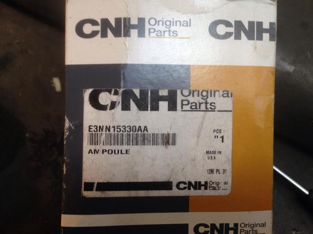

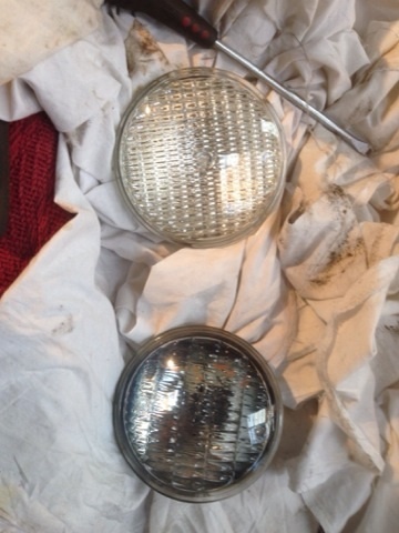

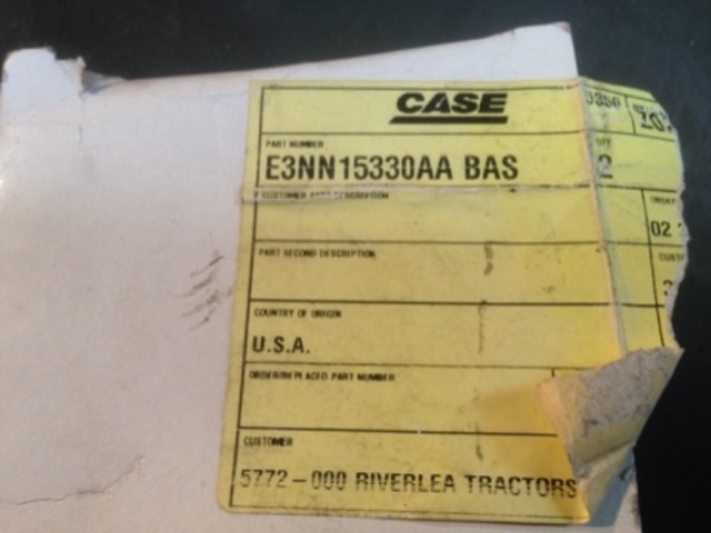

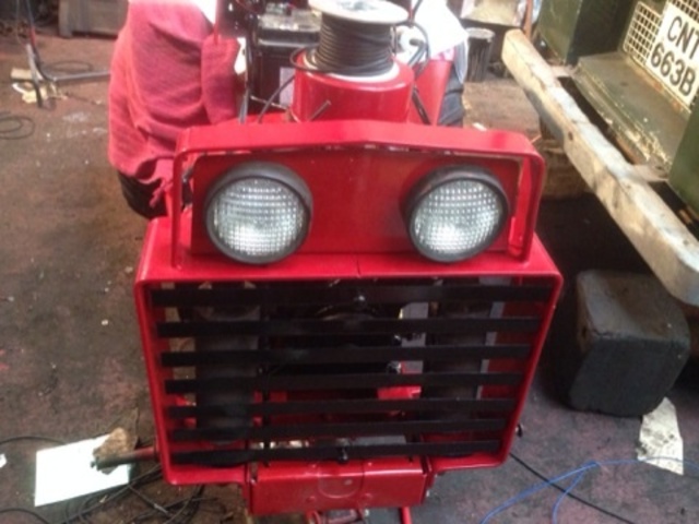

diggerjames 64 #176 Posted April 8, 2014 After reusing the original head lights which both worked one of them blew I was going to use LEDs but It wouldn't looked right so I've done some digging in my mates part stores who like my self restore old tractors especially David brown and Case International and has look would have it they are exactly the same as db 990 ,885 etc. I've put on the original box on for part no reference hope this helps anybody cheers James Share this post Link to post Share on other sites
meadowfield 2,737 #177 Posted April 8, 2014 they are really standard units, two a penny in the US - I brought two units back with me a few years ago. Over here still standard, but a bit pricier. They are easy to find in the rubbolite type assemblies used on plant equipment Share this post Link to post Share on other sites
leereynolds 0 #178 Posted April 11, 2014 I need the quick coupler to a D200 for my tiller. I cannot find the part, is it an option to drill and pin on the spline? Share this post Link to post Share on other sites
wheeledhorseman 579 #179 Posted April 11, 2014 Those head lights look fine James. To put prices in perspective, as a Toro / Hayter part they were about £18 each a couple of years back when I was doing my first D. In the US as a GE lamp rather than Toro part they were about $5 each. As I had had three tractors using them at the time, four now, I decided to import a box of ten which ended up costing me just under a tenner each including shipping and import duty. I thought it would be a lifetime's supply but I'm down to just a couple now so may do it again. The odd thing about the GE bulbs is that they are 12 volt rated as opposed to 14 volt and in the GE spec the life expectancy at 14 volt falls dramatically to just a few hundred hours though of course they run brighter. They also seem to crack easily at the back, not a problem with the rubber mountings used on a D series but it's an issue with the 300 series tractors etc where a metal tab holds the unit in place. If it's anything but a light pinch to secure the lamp then after extreme cold in winter you can find the glass has cracked. Andy Share this post Link to post Share on other sites

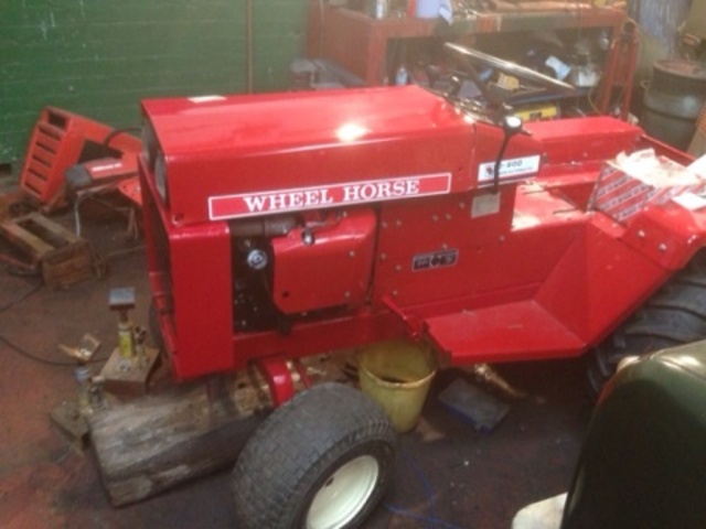

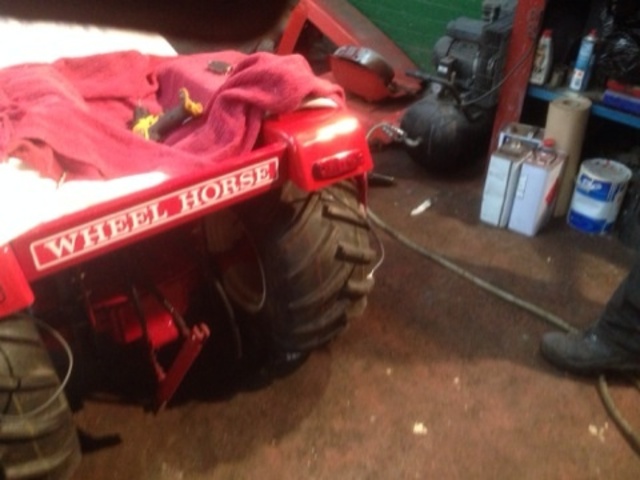

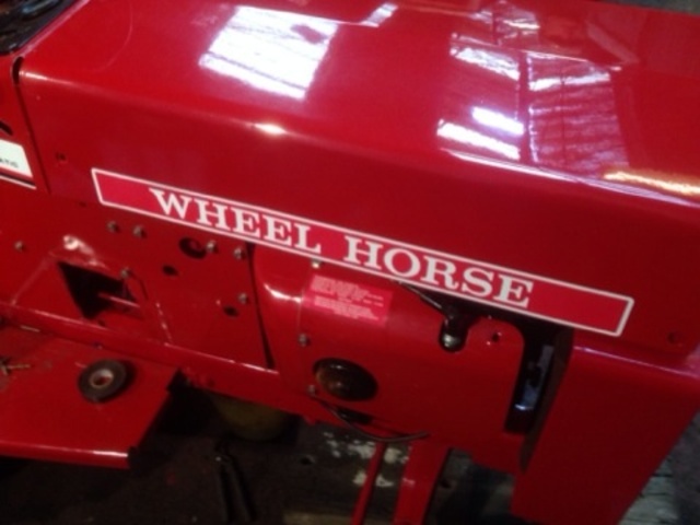

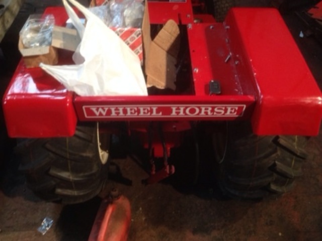

diggerjames 64 #181 Posted April 12, 2014 Hi all had a good day today fitted the new decals today which I got from Mark ( meadowfield ) and I must say they realy set the tractor off many thanks mark Cheers James 1 Share this post Link to post Share on other sites
meadowfield 2,737 #182 Posted April 12, 2014 Awesome work! Looking forward to seeing it Share this post Link to post Share on other sites
fabricator2009 48 #183 Posted April 13, 2014 Wow, that looks good. Share this post Link to post Share on other sites

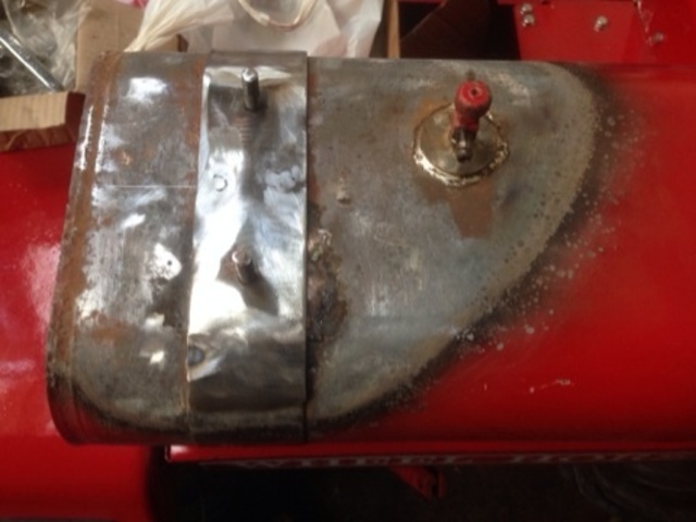

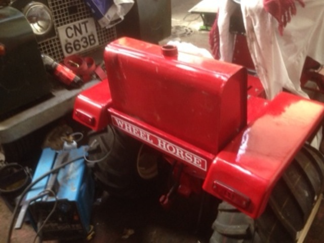

diggerjames 64 #184 Posted April 13, 2014 Hi all my mate paul Dibnah had had my fuel tank for a bit of specialist repair work and he's made a cracking job Share this post Link to post Share on other sites

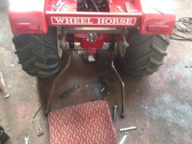

diggerjames 64 #194 Posted May 13, 2014 No mate it's not done yet just designing and building a 3 point linkage ! Thanks for your comments guys Share this post Link to post Share on other sites

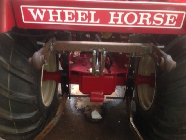

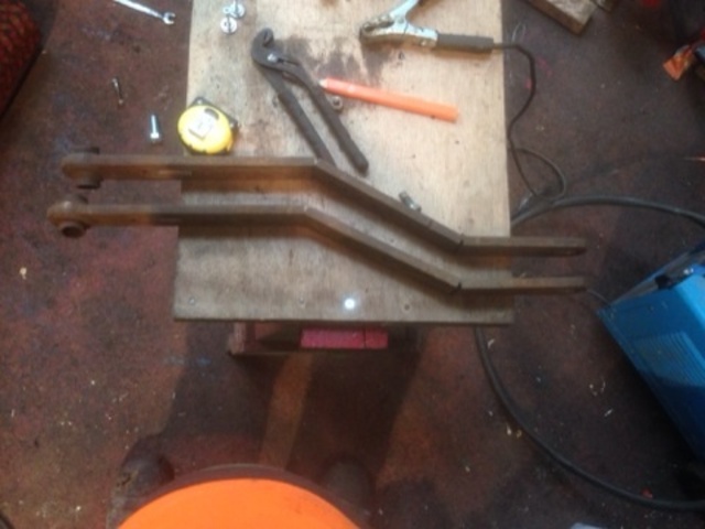

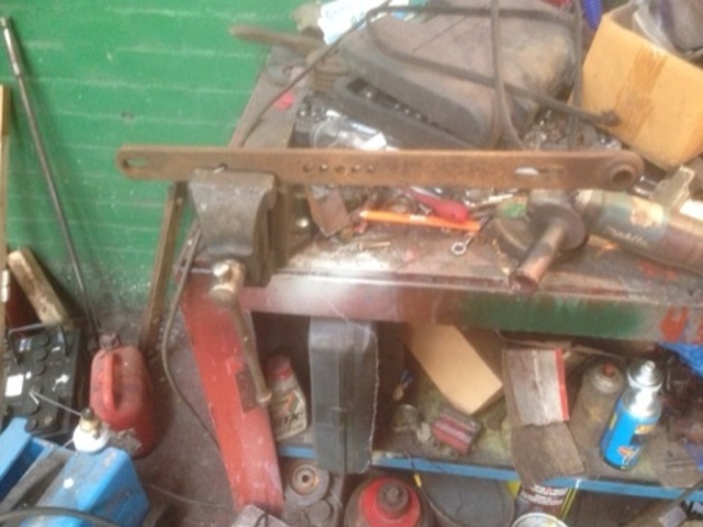

diggerjames 64 #195 Posted May 15, 2014 Hi all over the last few days I've been planing and building my three point linkage , I've been using ideas from various people to name a few Stigian and Meadowfield cheers guys these are the lift arms I've fabricated out of old fergy bars Share this post Link to post Share on other sites
meadowfield 2,737 #196 Posted May 15, 2014 looking good!!!!! Share this post Link to post Share on other sites

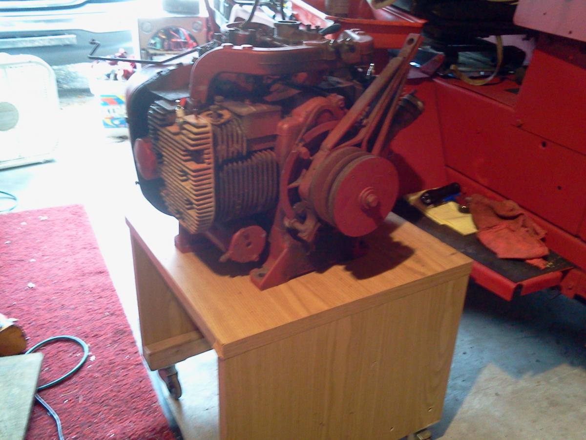

rtfbg 744 #197 Posted May 15, 2014 (edited) Hey gang ... another PITA question for you!!! My D has the Kohler engine, with NO stickers or markings visible. When I tear it down, is there anywhere else on it that I may find the model and serial number?? Edited May 15, 2014 by gulftane Share this post Link to post Share on other sites

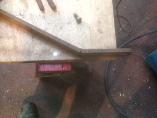

diggerjames 64 #200 Posted May 17, 2014 Hi all I've been busy the last couple of days cutting and grinding and welding to make my three point linkage here is what I've done so far 2 Share this post Link to post Share on other sites
