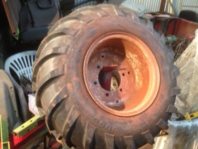

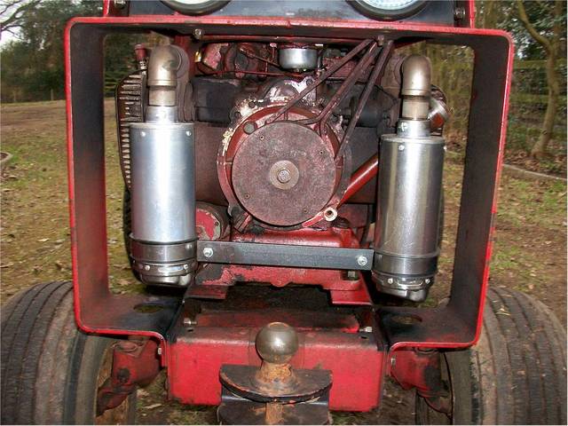

diggerjames 64 #151 Posted April 3, 2014 Yes mate I've ordered tyres from a firm near me at the same price you recommended so all been wel they should be here monday but I need to paint the wheels first etc I might fabricate two twin stainless exhaust stacks what do you think ? Share this post Link to post Share on other sites
meadowfield 2,931 #152 Posted April 3, 2014 Stacks might look and sound good, I know Andy's second D has none standard silencers and sounds fab! 1 Share this post Link to post Share on other sites
diggerjames 64 #153 Posted April 3, 2014 I need to service the engine and hydro as well Share this post Link to post Share on other sites
wheeledhorseman 579 #154 Posted April 3, 2014 Stacks might look and sound good, I know Andy's second D has none standard silencers and sounds fab! Stacks do look good on a D - go for it! So do front end loaders! The mufflers Mark is referring to are these dirt bike straight through cans. Wakin' up the dead when you open the throttle up! Re Newby Hall, I do hope to get there but things have got more complicated in the last year as we now have seven horses (equine sort) to look after on a daily basis. Hopeful, but it depends on my kids being around that weekend to do the honours. Andy Share this post Link to post Share on other sites

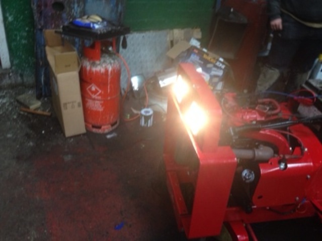

diggerjames 64 #158 Posted April 4, 2014 Evening all I've had an eventfull day with the D200 could get it to charge etc but I've cured that I've also got the origina headlights working I've manage to post a video on you tube of the first proper run still plenty left to do this should be the link - Cheers James 2 Share this post Link to post Share on other sites

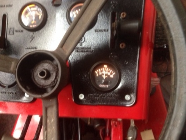

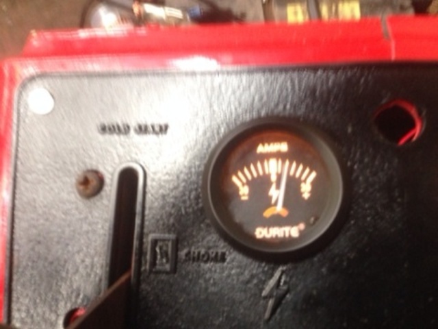

diggerjames 64 #159 Posted April 4, 2014 I've had a nightmare day today had it all planned but with work commitments I didn't get started while 2pm I noticed the ammeter never went up while engine was running so I checked all the wiring which I've just renewed went back to the diagram etc still couldn't work it out I had 7 .2 volts coming out of the rectifier so i then thought it's got to be that so I took it off cleaned it and realised they was some primer on the terminals so I cleaned it and put a direct earth to the casing to eliminate earth problems re connected it all , and I cracked it charges @ around 13.8 volts+ so good day after all. Cheers James Share this post Link to post Share on other sites
rtfbg 744 #160 Posted April 4, 2014 Whew!!! Dodged a bullet there!! Those stupid things are bringin around $120US here!!! Lookin sharp!!~ Nice job ... but, you had better slow down, when you're done, theres probably a honey do list waitin for ya!! LOL Share this post Link to post Share on other sites

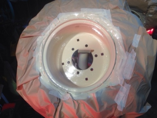

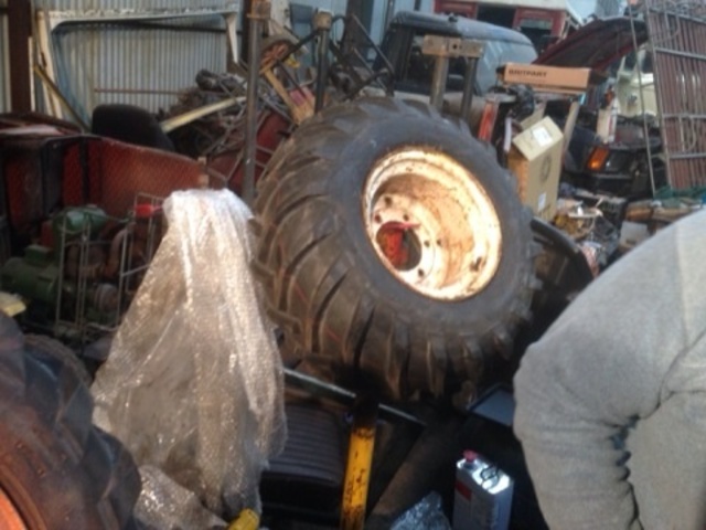

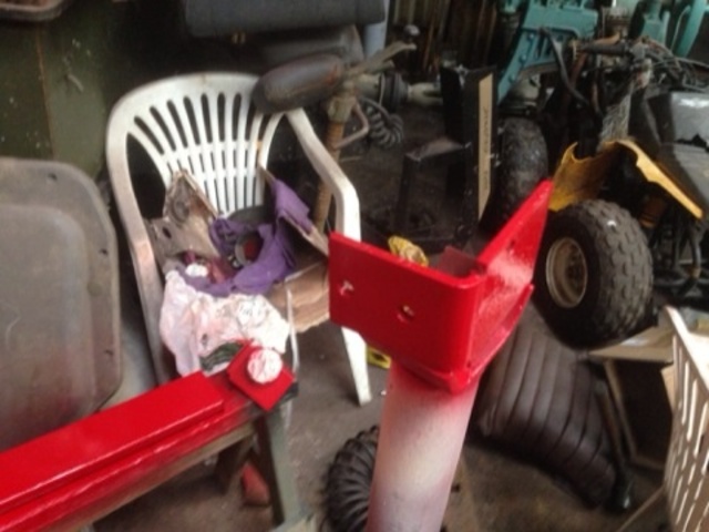

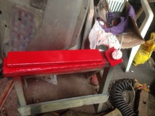

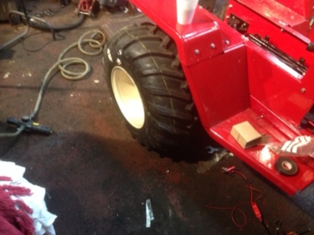

diggerjames 64 #164 Posted April 5, 2014 Hi all been busy today fitted the new tyres to the rims and cleaned them and painted them up plus other little bits for the rear linkage and front grill Cheers James Share this post Link to post Share on other sites

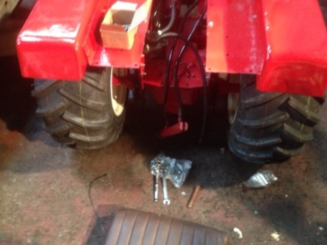

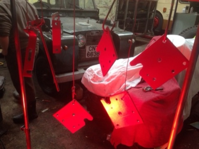

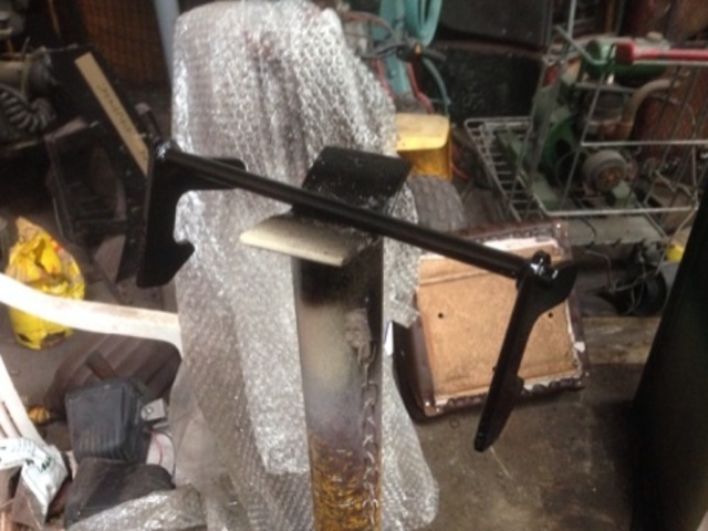

diggerjames 64 #167 Posted April 7, 2014 Hi all more little bits done tried the new tyres on today and painted a few of the tachomatic parts more pics to follow cheers james Share this post Link to post Share on other sites
