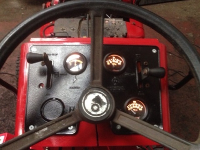

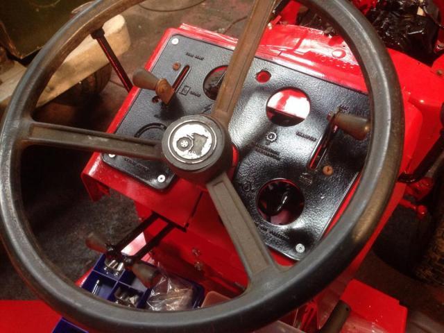

diggerjames 64 #133 Posted April 2, 2014 Starting to re fit the dash today and start a complete rewire , I've had to order a complete new set of gauges due to them been u/s . I retired the starter and ignition and with a quick flick she burst straight into life ) Cheers James Share this post Link to post Share on other sites

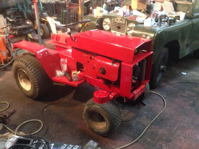

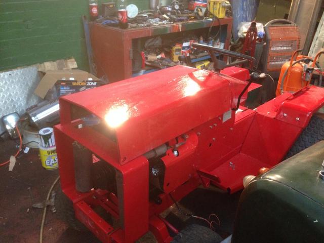

diggerjames 64 #135 Posted April 2, 2014 A good day tomorrow Mark and it should be more or less mobile just waiting on fuel tank to be mended etc then it's 3 point linkag design time Cheers James Share this post Link to post Share on other sites

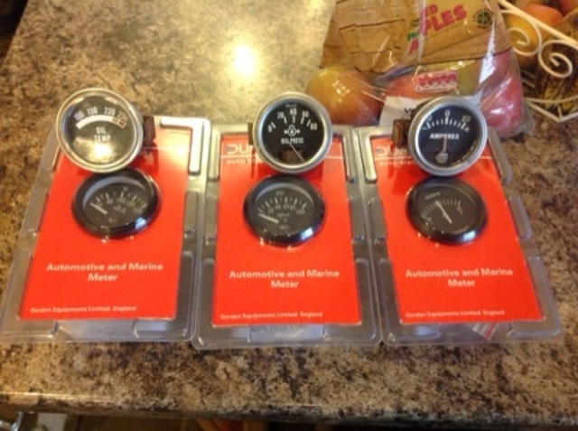

diggerjames 64 #141 Posted April 3, 2014 Hi Andy durite do a universal kit for the oil pressure with different fittings for the block which is about £30 and the ammeter and oil temp are about £20 each they should arrive today , more pics to follow James Share this post Link to post Share on other sites
diggerjames 64 #142 Posted April 3, 2014 The new gauges have come gonna fit this afternoon Share this post Link to post Share on other sites

diggerjames 64 #144 Posted April 3, 2014 Local auto electrical not much change out of a £ 100 tho but they do come with senders etc . Cheers James Share this post Link to post Share on other sites

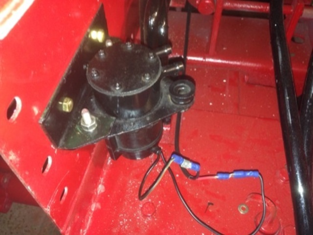

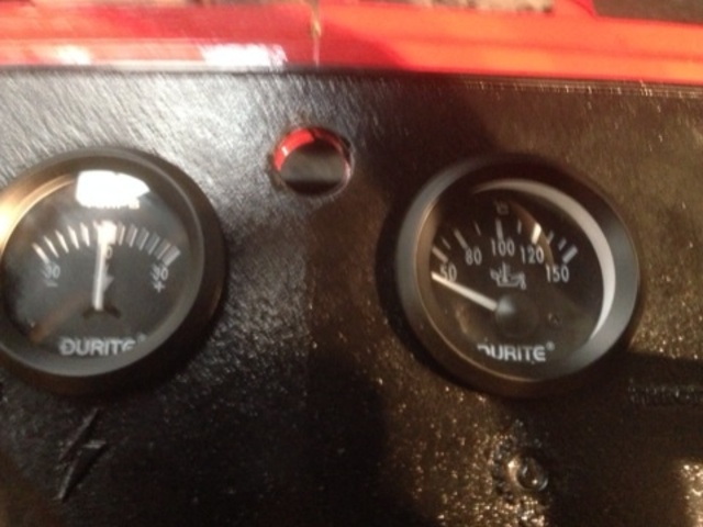

diggerjames 64 #145 Posted April 3, 2014 Hi folks been busy this afternoon total retired the dash and fitted the new gauges in which all work perfectly, I'm wondering now wether to get a hour meter your advice on this would be appreciated, and I've fitted an electric fuel pump Ashe vacuum unit had failed . The gauges also come illuminated so I've wired that up as well your opinions are welcome on this cheers James Share this post Link to post Share on other sites
wheeledhorseman 579 #146 Posted April 3, 2014 Love those dials James, may just have to do that with my D-200s. The original oil pressure guages are a real pain, neither of mine work correctly. I found it's not the guages but the senders which start playing about. I think I found you can still get the senders from Kohler but the price was sky high so I didn't bother. I wouldn't mind having your old sender off the Kohler to perform an autopsy. Re the hours meter, I have one D-200 with and one without (like yours). They're important with a hydro transmission if the tractor is a worker, so much so that I added one to my C-120 Auto so that I know when the tranny oil change and filter are due. My second D is used as a yard tug and it will be years before it ever needs a new filter so I haven't bothered adding a meter in the blank hole but i am thinking of adding a tacho into the spare hole. If your D is for showing then I don't think it's that important to have an hours meter. Just my opinion. Re fuel pumps - wise move! Put an electric one on the first D and it has started on the button ever since. Tried a new pulse pump on the second D. It was NOS for a Kohler Magnum I think but mouted ok. It works fine but suffers from the drain back to tank when left standing for long periods so I'm going to put an electric one on that too. You're doing a fine job there James Andy Share this post Link to post Share on other sites

meadowfield 3,177 #150 Posted April 3, 2014 What's left to do? Tyres and wheels? Share this post Link to post Share on other sites
