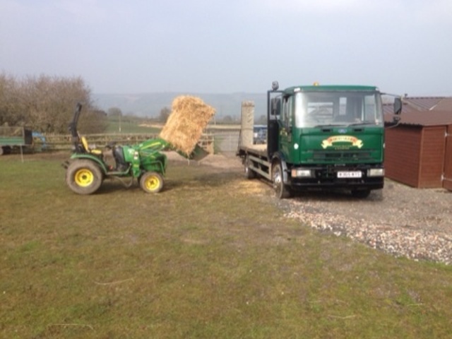

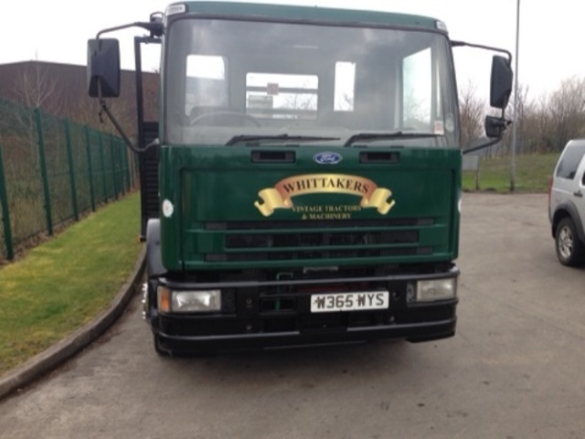

diggerjames 64 #104 Posted March 29, 2014 Just another pic off topic but this the wagon I've also done up for the shows etc excuse the john Deere on the pic Share this post Link to post Share on other sites
