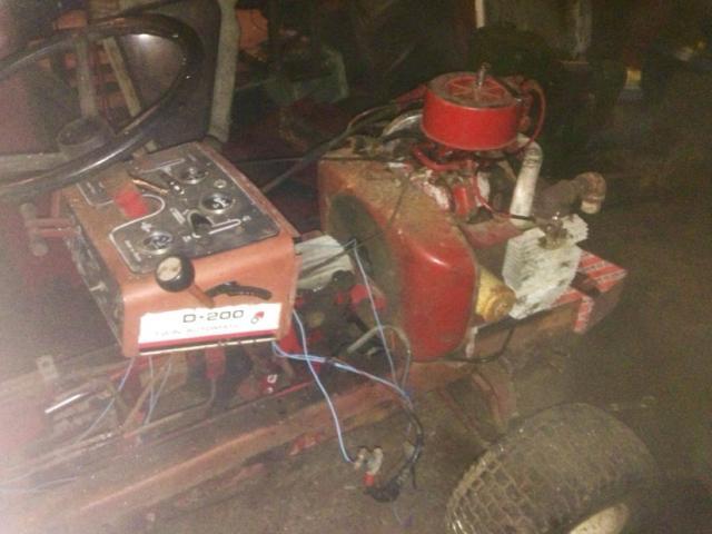

wheeledhorseman 579 #26 Posted January 9, 2014 Looking at the pics and decals (we're very much into decals at the moment) I'd say your D-200 is on the cusp of the 1977 - 1988 model. My 77 model has the typical red decals and original off white real wheels that can be mounted either way round to produce wide or narrow track. My 78 model has the later decal design throughout and wide rear wheels painted silver that only fit one way round, Yours has the red WH decals on the hood sides, yet the later style on the sides of the dashboard - difficult to say from the pics which rear wheels you have but they appear to be off white. More evidence like a dump cart I'm working on at the moment that there was a mix and match policy to use up stock at the changeover period. The number of these, and GT-14s for that matter, that entered the UK is an interesting one. The figure of 20 D-200s was second hand to me but originally from a guy who worked for WH over here. I don't know the origin of the GT-14 figure. My guess would be that these were the figures for a first batch of each shipped over from the US. Sales weren't high due to price so after that dealers ordered from the states if they had a sale so we'll probably never know the final total. It would also make sense in that both tractors had attachments specific to the model, in the case of D-200s this included actual tractor options as well like the 3-point hitch and turning brakes. A couple of times I've seen D-200s come up for sale with deck and rotavator and another with no deck but a rear mounted pto driven grass topper - I still regret not buying that one! My first D had no deck or signs of ever having one but did have the three point and turning brakes and judging by the way it got trashed did a lot of plowing in its time. So I'm guessing after the first batch you specified what you wanted at the dealers and they had it shipped from the US. Keep posting the pics! Andy Share this post Link to post Share on other sites

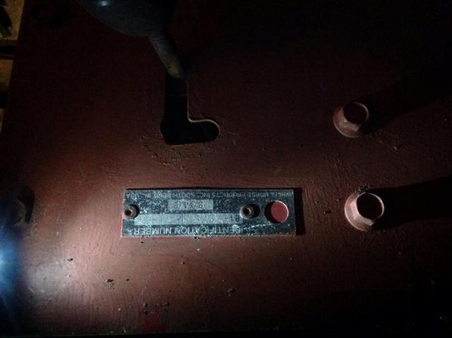

diggerjames 64 #28 Posted January 15, 2014 Just a quick update got the d running better new plugs etc . Taken a photo of vin number any info greatly appreciated age etc Share this post Link to post Share on other sites
wheeledhorseman 579 #29 Posted January 15, 2014 (edited) If my eyesight's good the that's 81-20KS01 and 1978 as I predicted from appearance.. I'll check the ser no of mine tomorrow if they're close then I guess they may have been imported about the same time. Andy Edited January 15, 2014 by wheeledhorseman Share this post Link to post Share on other sites

wheeledhorseman 579 #33 Posted January 16, 2014 (edited) I realised after posting the year bit for you that I should have explained a little more and in a way how to use the site. If you go to the model list section for 1955-1984 models and scroll down you'll find that the D-200 was first introduced in 1974 with a model number for that year of 1-0630. The list is here: Each year the model number changed and.... 1974: 1-0630 1975: 1-0631 1976: 61-20KS01 (2 variants that year also) 1976: 61-20KS02 1977 71-16KS01 (again 2 variants) 1977: 71-16KS02 1978: 81-20KS01 (just one model) The code tells us that yours is a 1978 20 hp tractor with Kohler engine. The full spec is given in the list and the engine is a Kohler K532S-53105A (Kohler K532S type engine, particular specification 53105A) If you go to the RS Manuals section i.e. Manuals - engines - Kohler, you will find some useful publications to download. Quick link http://www.wheelhorseforum.com/files/category/13-kohler/ The K532 service manual is on page 4 but you will find others of interest I think. One of these is dating a Kohler engine from its serial number which may help you put an approximate time of year to the 1978 bit. Unfortunately I don't believe there are any lists giving full date from the Wheel Horse serial number. Another valuable resource is that Toro have a parts lookup site here: https://lookup3.toro.com/partdex/index.cfm?xCaller=Toro&lang=us_en If you enter your tractor model 81-20KS01 and search you will get access to assembly drawings, product details, attachments and accessories. Welcome to RS, the only place to be and a great community. Feel free to PM me (private message). Andy Edited January 16, 2014 by wheeledhorseman Share this post Link to post Share on other sites

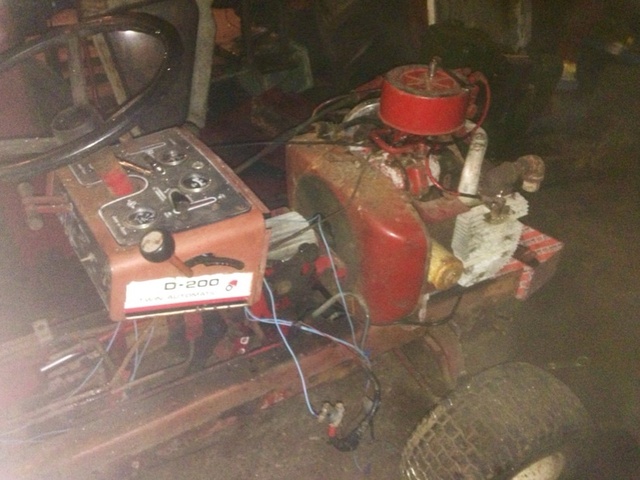

diggerjames 64 #35 Posted January 30, 2014 Stripped some more parts off today I'm n Now getting down to the nitty gritty but I've realised I'm not getting no oil pressure weather it's the gauge which is faulty I don't now so I'm going to investigate that next . Photos coming shortly! James Share this post Link to post Share on other sites

wheeledhorseman 579 #39 Posted January 30, 2014 Stripped some more parts off today I'm n Now getting down to the nitty gritty but I've realised I'm not getting no oil pressure weather it's the gauge which is faulty I don't now so I'm going to investigate that next . Photos coming shortly! James As you know, I have two D's and the oil pressure guage on each have good days and bad days. Cleaning the connections on the dash gauge and the one on the sender unit helped a bit but on mine but I suspect that the sender units really need replacing. I seem to recall that they are available from Kohler but typically pricey so I didn't bother. Andy Share this post Link to post Share on other sites

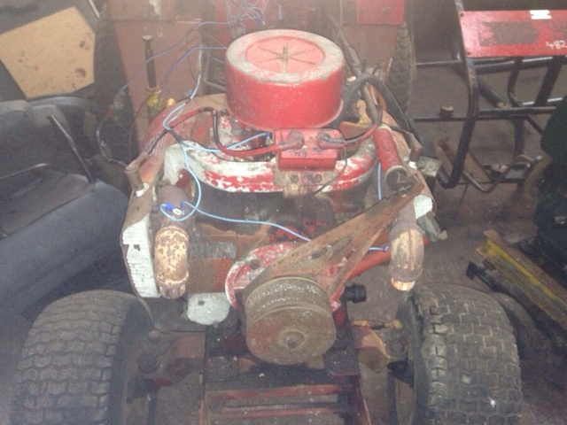

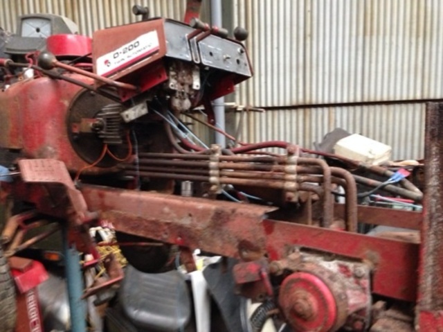

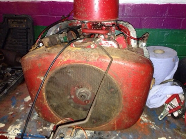

diggerjames 64 #40 Posted February 7, 2014 A few more pictures of the strip down The massive kolher 20 hp Share this post Link to post Share on other sites
wheeledhorseman 579 #41 Posted February 8, 2014 These photos bring back memories - keep posting Andy Share this post Link to post Share on other sites
diggerjames 64 #42 Posted February 8, 2014 Parts are building up,! 2 Share this post Link to post Share on other sites

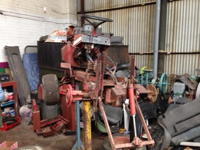

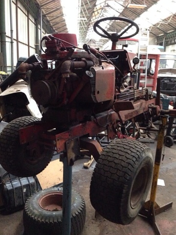

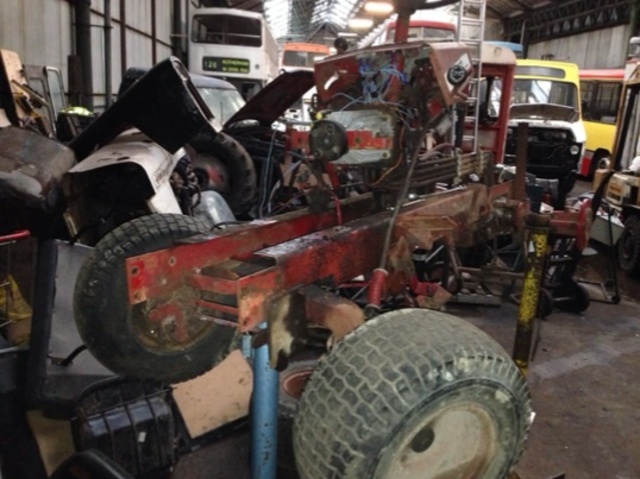

diggerjames 64 #44 Posted February 17, 2014 Just put the d on big axle stands to aid stripping painting and cleaning Share this post Link to post Share on other sites

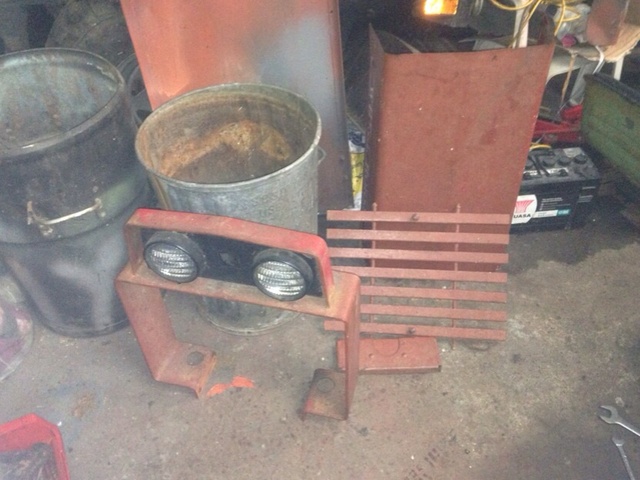

diggerjames 64 #45 Posted February 17, 2014 A few more pictures of strip down before been spayed in degreaser Share this post Link to post Share on other sites
cleat 9,284 #46 Posted February 17, 2014 Wow, when you lift a tractor you don't fool around. That looks like quite a shop you have there. Looking forward to more pictures of your progress. Cleat Share this post Link to post Share on other sites
diggerjames 64 #47 Posted February 17, 2014 Thanks cleat we also restore vintage busses etc and that's what the axle stands are for cheers james Share this post Link to post Share on other sites
JamesBe1 84 #48 Posted February 18, 2014 Nice work. Having it up high really makes it easier on the back. BTW, I think several members would really love to see what kind of luck you have getting the steering wheel and rear hubs off. I'm looking forward to more pics. j Share this post Link to post Share on other sites
