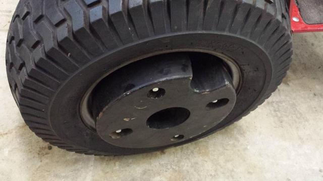

JERSEYHAWG / Glenn 4,499 #5 Posted January 7, 2014 Ok....crisis over lol. My brother convinced me to set these weights on the rims correctly. We used 1/2 inch by seven inch carriage bolts. They each have 2 beefy washers with a beefy lock washer and nut holding them in place. Being as these cast iron weights are so heavy we wanted to make sure of attachment to the rim. That's why 4 carriage bolts per weight. Also by the carriage bolt head being locked into the rim " square fits into square hole " we felt that would cut down on cavitation and the weight wanting to roll in the rim. The manufacturer of the tire rim had to put that square hole into the rim for this reason. 2 pictures below. Thanks for the advice though. It's much appreciated. Glenn 3 Share this post Link to post Share on other sites

Tankman 3,526 #8 Posted January 7, 2014 I use carriage bolts, square head in the square rim holes. Hey, as mentioned above, square holes in the rims for a reason. Darn cold out there today, lucky my stallions are in the barn! 2 Share this post Link to post Share on other sites

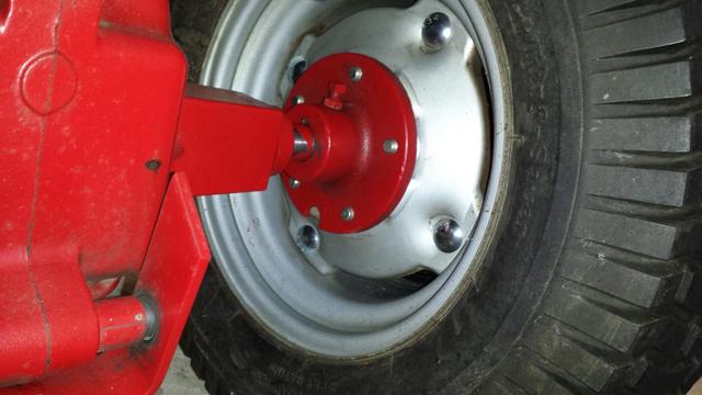

Martin 2,133 #12 Posted January 9, 2014 (edited) i think you will find the majority of wheel hub threads are 7/16-20 especially for the type of hubs shown in the pic above. there are exceptions though. just don't want anyone going out and buying the wrong size...... Edited January 9, 2014 by Martin 1 Share this post Link to post Share on other sites
doc724 925 #13 Posted January 9, 2014 I agree with Martin, 7/16-20 bolt size. I just had this same discussion with Saltwatersailor in MD who confirmed the bolt length as well. The acorn nuts are from 1980-1990 or so GM products. I have not converted mine yet-just too damm cold to go into the garage, but I am thinking to get closed end chrome plated acorn nuts to keep the nuts from rusting to the studs. I found them for about $14 on ebay for a package of 20-enough to do two tractors. Open end ones are less $ of course Share this post Link to post Share on other sites
