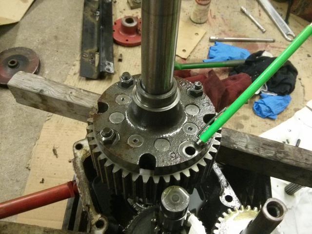

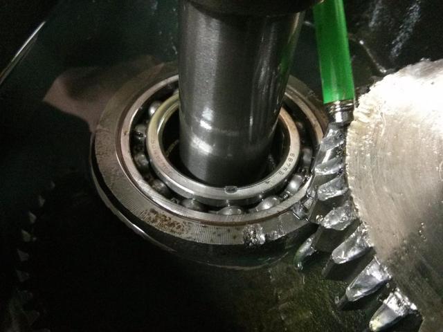

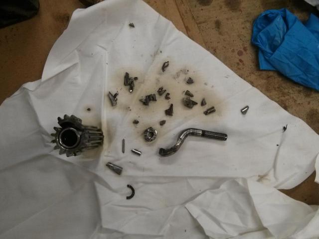

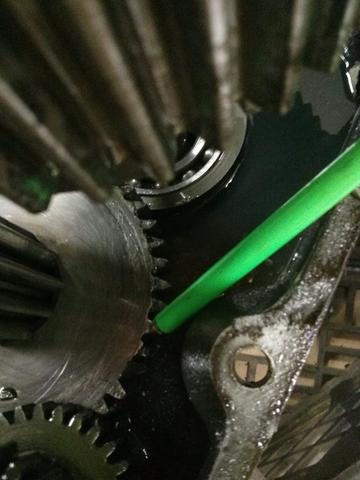

mrc 1,020 #27 Posted January 16, 2014 (edited) hi men, as promised here are some pics that my younger friend took with his phone. technology is amazing. the carnage hurts! regards mike in mass. Edited January 16, 2014 by mrc 1 Share this post Link to post Share on other sites

pfrederi 19,293 #30 Posted January 16, 2014 IMG_20140116_114206.jpgIMG_20140116_114237.jpgIMG_20140116_114255.jpgIMG_20140116_113731.jpg hi men, as promised here are some pics that my younger friend took with his phone. technology is amazing. the carnage hurts! regards mike in mass. Ouch!! Mcmaster has grade 9 bolts and locking nuts that i have been using in differentials lately Share this post Link to post Share on other sites
mrc 1,020 #31 Posted January 17, 2014 hi men, i had thought about adding to the gussets doc724. i'll look into those grade 9 bolts paul. this machine is a 1985. i bought it used in 1995. i never did anything to the tranny except change oil. my question is, was someone inside the tranny between 1985 and 1995? i ask because there are lockwashers under the HEADS of the differential bolts (which seems a little odd to me) also as you can see in the pics where the metal locknuts are there is a relief cut in the differential. inside the relief cut are marks from what looks like a serrated shouldered nut. so my question is based on the pics is this normal factory assembly looking stuff ??? thanks mike in mass. Share this post Link to post Share on other sites
stevasaurus 23,518 #32 Posted January 17, 2014 You would not think anyone would be in a trans in the first 10 years, but who knows. Share this post Link to post Share on other sites
racinfool40 203 #33 Posted January 17, 2014 Every 8-pinion differential I have pulled,,Being in an 8-speed or a hydro the locking nuts have been on the bolt side and not the nut side...if you needs parts to fix I have them on hand... Mike. 1 Share this post Link to post Share on other sites
stevasaurus 23,518 #34 Posted January 17, 2014 About time you got in here Mike...I figured you would know the answer to that question. Do you believe the picture above of that bolt??? Un-real... 1 Share this post Link to post Share on other sites
TT-(Moderator) 1,169 #35 Posted January 17, 2014 X2 on the fifth hole in the mounting plate being for the lift cable on the hydro tractors. The "serrations" on the differential end cap are probably chatter marks from the tool used to spot-face the "pad" where the nut seats. The object of the game is keeping the through-bolts tight. High-quality locknuts and thread locker are your friends. Here's what happened to a friend's '86 417-8 tranz when a through-bolt decided to pass under the ring gear: 2 Share this post Link to post Share on other sites
mrc 1,020 #36 Posted January 20, 2014 (edited) hi men, rich(312hydro): i'm an 8 speed guy with little to no hdro experience so thank you for enlightening me. mike(racinfool40) i will definitely contact you for some gears for my damaged unidrive. it may be awhile though as i plan to swap in my spare tranny and rebuild when the weather is better. i can't see scraping it when rebuilding is possibe. i was busy this weekend preparing for a medical procedure . best regards mike in mass. Edited January 20, 2014 by mrc 1 Share this post Link to post Share on other sites

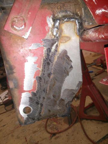

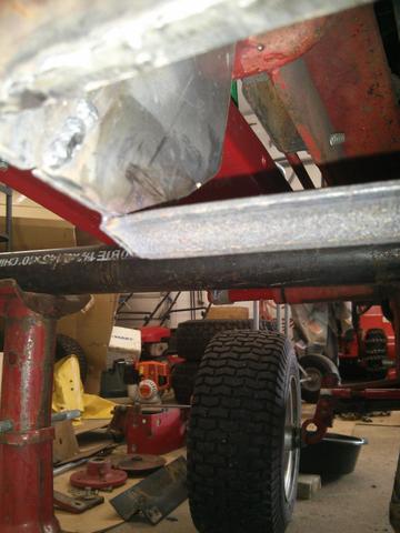

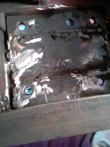

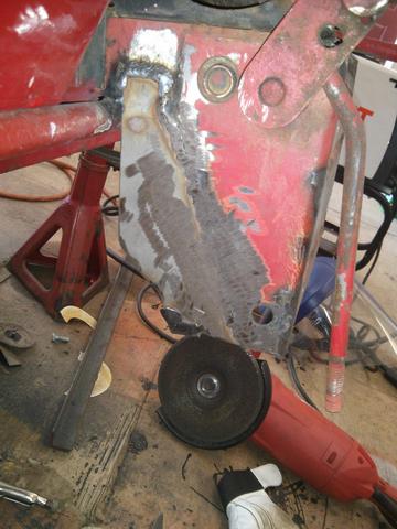

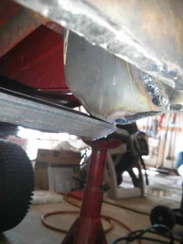

mrc 1,020 #40 Posted February 4, 2014 Hi men here r some pic of 1/4" tranny mount and 1/8" gussets and a piece of angle iron for extra strength connecting the gussets 1 Share this post Link to post Share on other sites
doc724 925 #41 Posted February 5, 2014 It took me a while to get oriented to what I was seeing in the pix. I did not expect to see the gussets ground flush. They look pretty beefy-no flexing there. It must be nice to have welding experience. What is that silverish looking bar that runs parallel to the pipe that is supported by the jack stands? (pix #4 on the right) Share this post Link to post Share on other sites
mrc 1,020 #42 Posted February 6, 2014 hi don, the silverish bar is the piece of angle iron tying the bottom of the 2 added gussets together. you can also see the angle iron in pic 1 and 5. the light is just reflecting differently on the pic in question. i bought my hobart 140 welder about 5 years ago. i have been self learning ever since. its a great machine. was made in USA, biggest welder to run on regular 110 volt home power and can weld up to 1/4 inch thick metal. it also came with the regulator to use shielding gas. the shielding gas makes a huge difference in the quality of the welds. i beveled the original gussets and the added gussets where they meet. then clamped together and welded. then ground down as best i could. they are welded on the back (inside) as well. best regards mike in mass. Share this post Link to post Share on other sites
