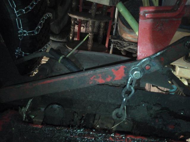

wheelhorse309w 0 #1 Posted January 4, 2014 (edited) I'm assuming that I have the front mounted correctly because the belt fits but I don't have anywhere to mount the flag pin. The closest place is on the lift arm, but this does not lift the blower. The arm that I see in the manual and online pics seems to be 6-8 inches farther back as you can see on the top right of the picture. Edited January 4, 2014 by wheelhorse309w Share this post Link to post Share on other sites
Trouty56 567 #2 Posted January 4, 2014 (edited) Yeah....that is wrong....your pic is upside down by the way. Keep going back until you see the part of the rock shaft that points down....there should be 3 holes in it....pick the second bigger hole up....well since you have a hydraulic lift it probably doesn't matter. The flag assembly has to push the blower up.... The lift tube should be longer than that.... Edited January 4, 2014 by Trouty56 Share this post Link to post Share on other sites

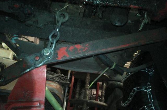

wheelhorse309w 0 #3 Posted January 4, 2014 (edited) Hopefully this picture is the right direction. So I need a longer tube? Did they make different lengths for different tractors ? Or an extension ? Edited January 4, 2014 by wheelhorse309w Share this post Link to post Share on other sites

Operator 7 #5 Posted January 5, 2014 Flag needs to go farther up into the lift point that the chain is attached to. Flag will only fit in one of those holes . Share this post Link to post Share on other sites
