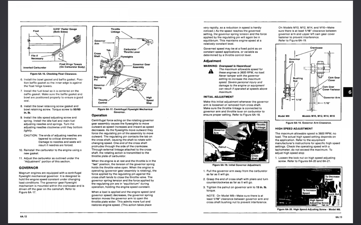

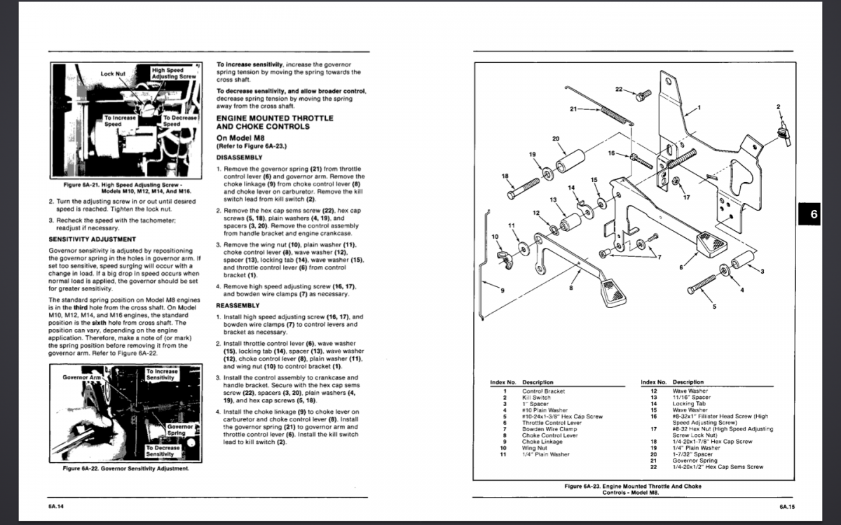

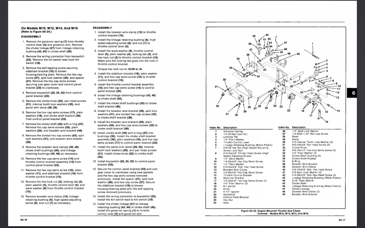

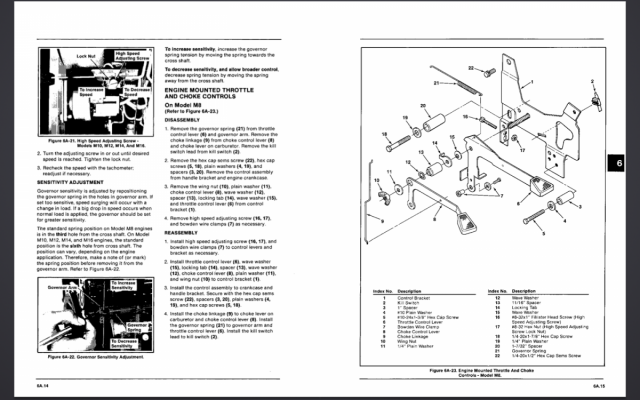

Martin 2,133 #15 Posted January 3, 2014 here is an excerpt from the manual on the governor. i would recommend that you go through and check to see everything is connected how it should be. the pics you posted don't really give us much detail. Share this post Link to post Share on other sites
