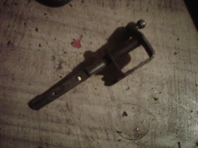

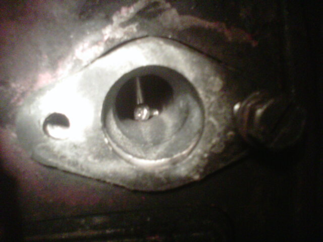

jakeC-121 9 #1 Posted January 2, 2014 Hi I'm new to the world of WH! Saved a horse with a bad case of malnutrition... Must be if its trying to eat its self!.(Pic1) now in pics 2 and 3 along with this arm/spindle there's suppose to be some sort of bushing in there but I can't see any??? The arm its self has worn a lot but how much would you guys say is to much?? Thanks jake Share this post Link to post Share on other sites
meadowfield 3,191 #2 Posted January 2, 2014 Looks like a whole piece missing! The screws look to have sheared off for the butterfly, and the butterfly has gone AWOL! Share this post Link to post Share on other sites
jakeC-121 9 #3 Posted January 2, 2014 Lol yes and no one was broken off already 2nd one loose. I have the butterfly and minni screw... Share this post Link to post Share on other sites
Anglo Traction 761 #4 Posted January 2, 2014 Jake, That screw in the intake by the valve look's like an Air Filter Body Screw?. Those brass Throttle plate screws are not at all strong and can shear off. There is a specific way to get them out. Not sure how far you've searched for answers etc here, but if you haven't seen it, maybe a read through a Thread I posted recently on the same size Carb. Take a look through it, then we'll see if we can sort what's needed in the way of parts and help. Regards Share this post Link to post Share on other sites
jakeC-121 9 #5 Posted January 3, 2014 Yes I think it is part of the air intake there's meant to be 4 holding it together. Undid 3 all different heads which was nice and the last one in there . Thanks for the link going to have a looksee Share this post Link to post Share on other sites

jakeC-121 9 #8 Posted January 16, 2014 (edited) i have got it in shop at the min. they think they can make a bush to fill the gap wont know of its worked till i can get it back Edited January 16, 2014 by jakeC-121 Share this post Link to post Share on other sites
Anglo Traction 761 #9 Posted January 16, 2014 Ok. thanks for getting back on this. If still needed, I can make you up a bronze bushing and any screws?. Have a spare Kohler Carb Repair Kit (gaskets/valve) if you need one of those as well?. Otherwise, hope you get her going soon. Regards. Share this post Link to post Share on other sites
jakeC-121 9 #10 Posted January 16, 2014 i think thats what there going to make as it will be cheaper than making a new shaft. the carb repair kit may be handy as i am planing to restore it. how much would you want for it? Share this post Link to post Share on other sites
