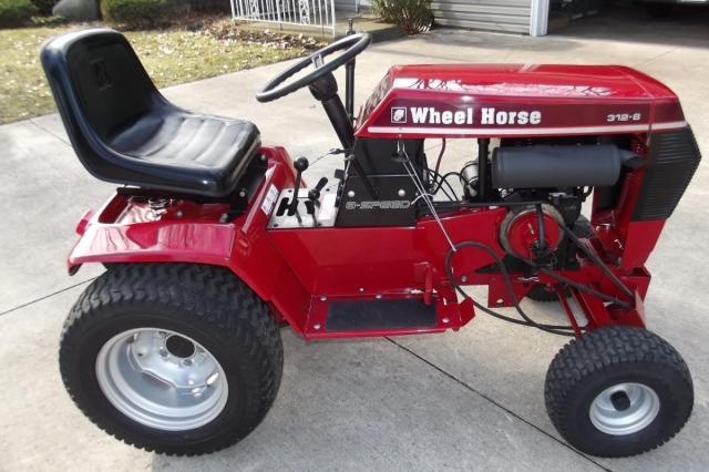

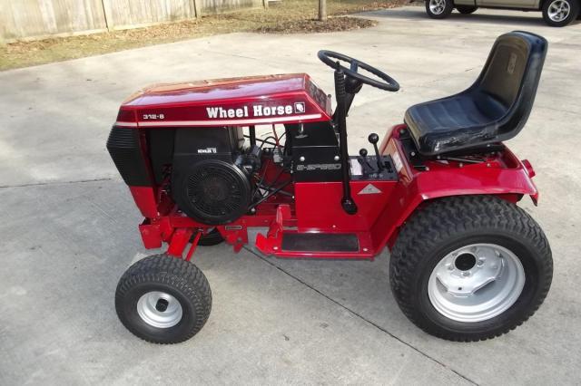

BOWTIE 226 #1 Posted December 29, 2013 I FINISHED THE CLEANUP ON MY 1988 312-8 TRACTOR. HERE IS THE FINISHED PRODUCT. I WILL TRY TO SELL IT IN THE SPRING. IT HAS 3 YEAR OLD 42" DECK AND 610 HOURS ON TRACTOR. BOWTIE IN OHIO 11 Share this post Link to post Share on other sites

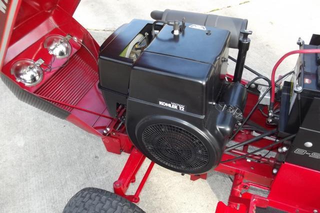

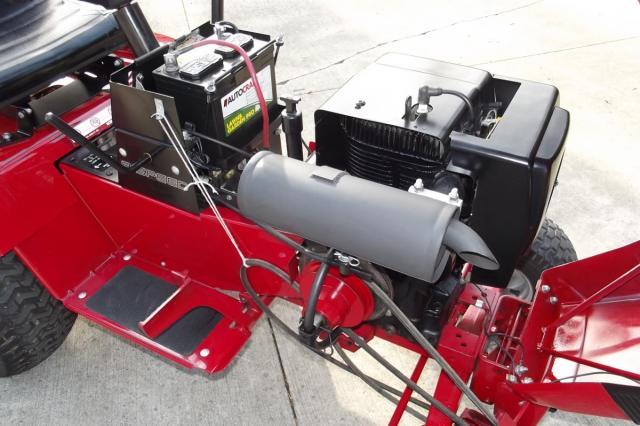

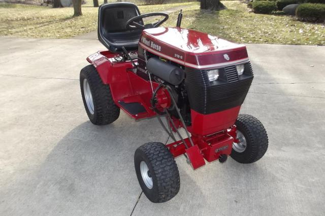

Jrblanke 918 #6 Posted December 29, 2013 Beautiful job! What steps did you take to clean it? Simple green then pressure wash? Also, what type of paint did you use to paint the muffler? Thanks, James Share this post Link to post Share on other sites

BOWTIE 226 #10 Posted December 29, 2013 JAMES, I PRESSURE WASH IT FIRST. THEN A LITTLE KEROSENE AND A PAINT BRUSH. THEN A GOOD SOAPY BATH WITH DAWN DISH SOAP. I DID USE SIMPLE GREEN ON THE TIRES/WHEELS AND REPAINTED THE WHEELS DULL ALUMINUM. THE MUFFLER WAS GLASS BEADED THEN PAINTED WITH BBQ PAINT. THE FRONT AXLE AND REAREND I WIPE WITH LACQUER THINNER THEN CLEAR COAT THEM FOR THE SHINE. THANKS Share this post Link to post Share on other sites

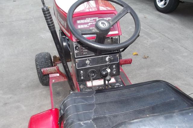

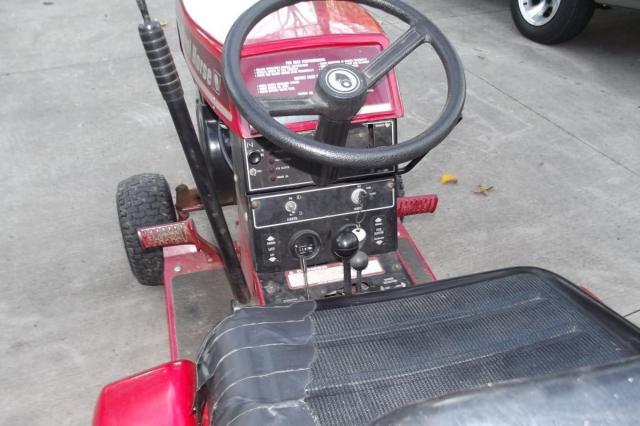

Sparky-(Admin) 24,813 #18 Posted December 29, 2013 What did you use on the seat where it was duct-taped? Mike........ Share this post Link to post Share on other sites

BOWTIE 226 #21 Posted December 29, 2013 HELLO SPARKY, MORE DUCT TAPE. I DISMANTLE THE SEAT AND DID A NICER JOB. IT WILL NEED A NEW SEAT IN THE FUTURE. BOWTIE Share this post Link to post Share on other sites
