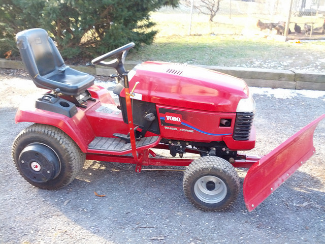

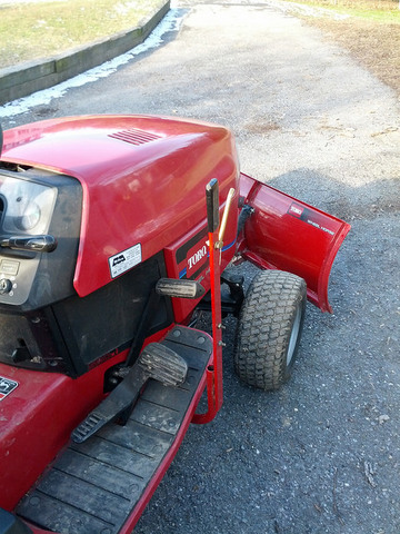

Usmc1968 30 #12 Posted January 20, 2014 (edited) Ok, here she is with the blade installed And just in time. We are expecting 6-8" tonight!! All I have left to do is put on the chains.. Semper Fi Edited January 20, 2014 by Usmc1968 Share this post Link to post Share on other sites
Sparky-(Admin) 23,990 #13 Posted January 20, 2014 Looks perfect! Your gonna have a blast clearing the snow with that set-up. Mike.......... Share this post Link to post Share on other sites
