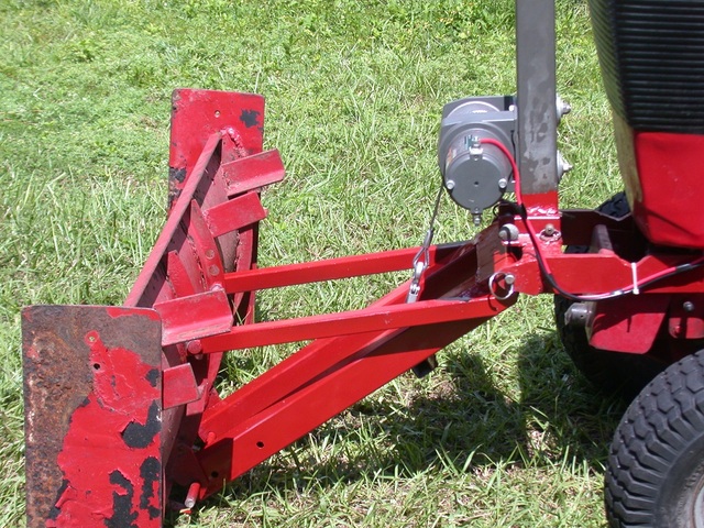

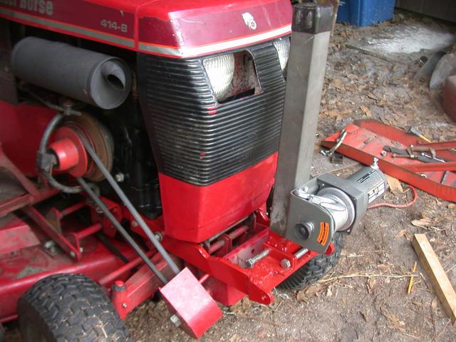

over60pirate 24 #3 Posted December 24, 2013 I made front & rear winch mounts for my WH. By pulling 1 pin, I pivot the winch mount forward, so I can raise the hood. The picture was taken, before I bolted an eye bolt at the top, for a pulley. Works great. In the rear I use it to raise a tine dethatcher, I use to collect pine cones and needles. 1 Share this post Link to post Share on other sites

over60pirate 24 #11 Posted December 30, 2013 Have since, mounted a pulley on the winch mount post, and attach the winch hook, closer to the plow, for easier lift. Winch removes with 2 pins to move to rear of tractor. Removing 1 pin, allows the mount to pivot, to allow the hood to open. Has worked good for a few years now. If doing again, I would make the plow mounting pin, larger than the 1/2" one I used. 1 Share this post Link to post Share on other sites
