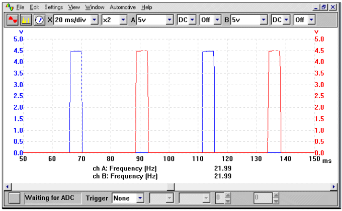

on a computerized ignition system, the signal fed to the tach is a very clean electrical pulse which varies from 0 volts to approx.12 volts (some engine computers may put out a 0 to 5 volt square pulse).

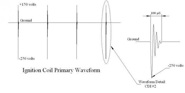

on the negative terminal of an ignition based system, the signal to the tach contains an electrical spike which can exceed 300 volts. The tach filter probably filters out the 300 volt spikes by cutting it off at its electrical "knees" and results in a much lower level voltage being presented to the tach.
Old school tachs will already have this simple filter inside the case as they are expecting a more "hostile" input signal . Newer tachs may require this filter to prevent damage to the tach circuitry.
