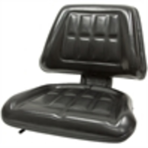

wallfish 19,379 #6 Posted December 20, 2013 This looks just like the original seat on my '87 416 http://www.surpluscenter.com/Brands/Seat-Solutions/135-DELUXE-HIGH-BACK-BLACK-SEAT-1-3202-BK.axd Share this post Link to post Share on other sites

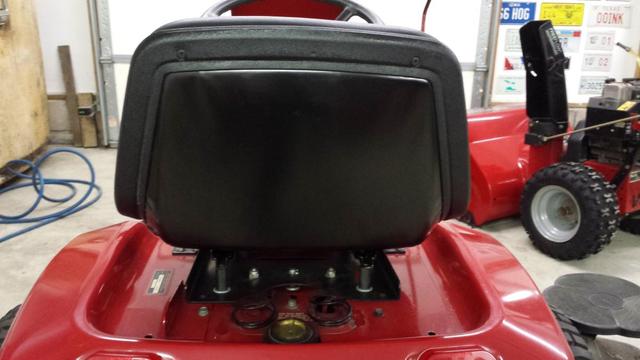

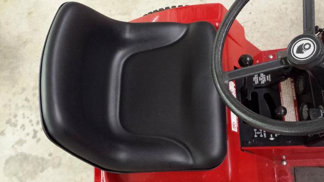

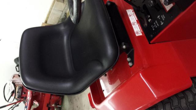

JERSEYHAWG / Glenn 4,528 #12 Posted January 2, 2014 Ok gentleman. Progress re. Items The manuals etc. We're pointed about by Garry. A big thank you for that. Re the gas seat spring I have one ordered from auto zone. Will keep you guys updated when that happens. The big news was finding the replacement seat with that odd bolt spacing 7 1/2 inches by 8 inches. Well a big thank you to surplus center tip off. They had the seat. The dimensions on the seat are a bit smaller. But I think it's great. I just finished installing it. Pictures below. Thanks again for the tip. And if anyone needs a seat this is a beauty. 39 bucks plus shipping. Any questions. Please ask me. Share this post Link to post Share on other sites

JERSEYHAWG / Glenn 4,528 #14 Posted January 3, 2014 foozerush, If you look a few posts above my post. Kegler posted a link to surplus center. open it up and search,,,,tractor seat. when you see the one for 39 bucks your there. check bolt dimensions on the seat your looking at. Its in the description. Glenn Share this post Link to post Share on other sites
Kegler 68 #15 Posted January 4, 2014 Glad I could help. The seat looks great! Share this post Link to post Share on other sites
submcpo 1 #16 Posted March 17, 2014 (edited) Glenn - My 418-A has the same bolt pattern as you said you needed. The surplus center listing gave a pattern of 7-1/2 by 7, but no 7-1/2 by 8. Did this seat bolt up directly or did you have to drill new bracket holes for the 8 inch dimension? Thanks. Dave Edited March 17, 2014 by submcpo Share this post Link to post Share on other sites
JERSEYHAWG / Glenn 4,528 #17 Posted March 17, 2014 Glenn - My 418-A has the same bolt pattern as you said you needed. The surplus center listing gave a pattern of 7-1/2 by 7, but no 7-1/2 by 8. Did this seat bolt up directly or did you have to drill new bracket holes for the 8 inch dimension? Thanks. Dave Dave, it bolted up directly. Did not have to alter anything at all. Btw,,,wellcome to red square, dont forget pictures. This site is a fantastic place for information. I allways liked that 418. Dont be a stranger. Glenn Share this post Link to post Share on other sites

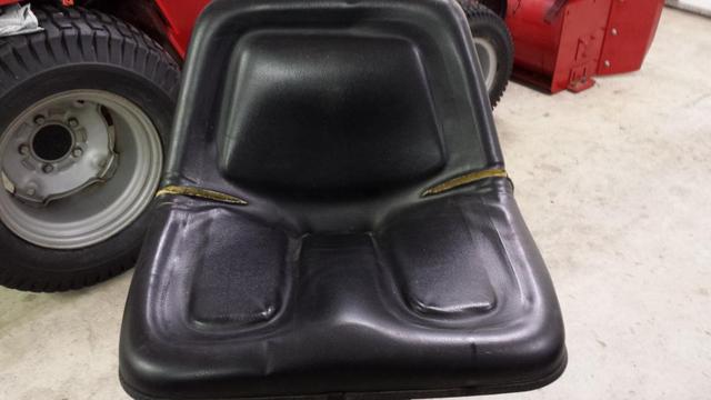

squonk 45,592 #18 Posted March 17, 2014 That seat looks great but I tried one and there wasn't enough padding in it for my taste. I got the first seat pictured here from TSC. Very comfortable. The 2nd seat pictured I got from The Surplus ctr. I've had it 8 yrs. or so and it's the best tractor seat I ever sat on! 2 Share this post Link to post Share on other sites

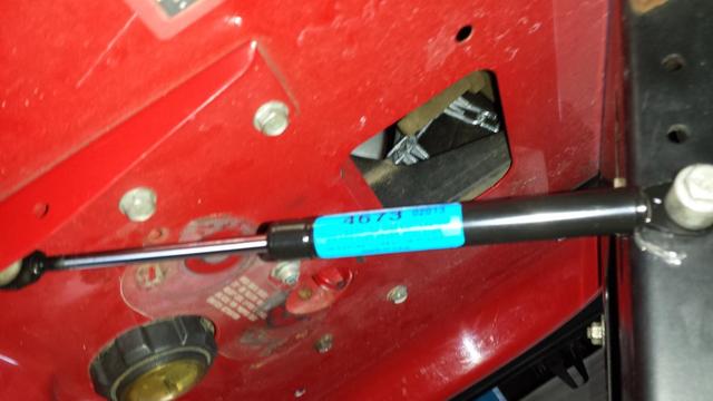

BOWTIE 226 #20 Posted March 19, 2014 THE GAS SHOCK SPRING CAN BE BOUGHT AT AUTO PARTS STORE. PART NUMBER IS: F4673 MADE BY STRONGARM AND COST AROUND 15-20 BUCKS Share this post Link to post Share on other sites
JERSEYHAWG / Glenn 4,528 #21 Posted March 21, 2014 (edited) Like this..... Glenn Edit: I had 2 of those shocks delivered today,,ebay,,$29. bucks for the pair,,free shipping. bolted one up real quick for the picture, then figured out it was bolted up wrong,,its since been bolted up correctly.. Bottom line,,new seat, new gas shock, one extra gas shock spare. Edited March 22, 2014 by JERSEYHAWG / Glenn Share this post Link to post Share on other sites
