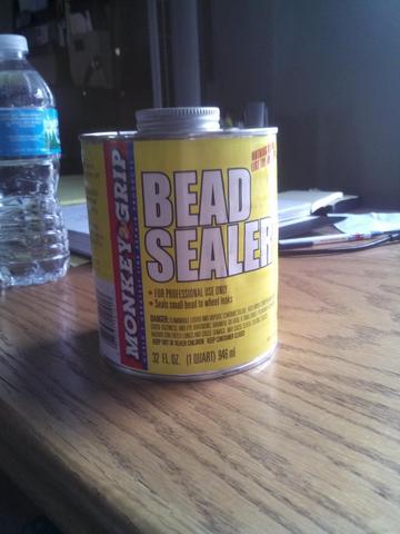

608KEB 812 #29 Posted December 13, 2013 (edited) I pulled a tube out from a PO. Cleaned up the inside of the rim and used this bead sealer (Monkey Grip). It's been a year and I haven't added any air to the tire. I also put a new stem on it. Edited December 15, 2013 by 608KEB 2 Share this post Link to post Share on other sites

Digger 66 3,525 #33 Posted December 14, 2013 Clean up the inside of the rim and use bead sealer. X - 2 ^ Share this post Link to post Share on other sites
