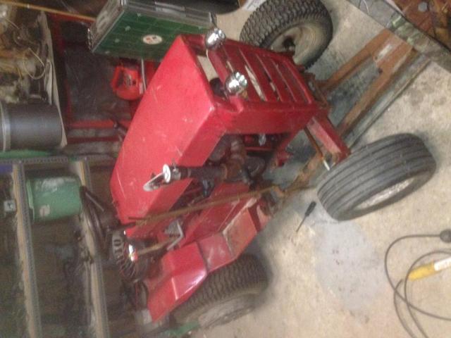

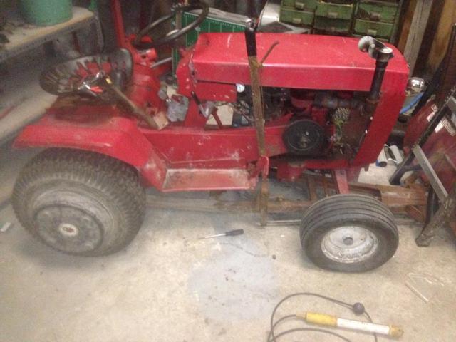

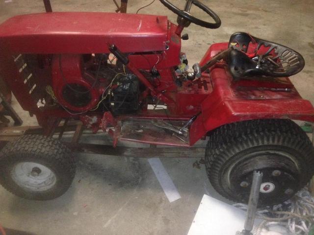

How about posting a picture of it?
If it's got a K181 with high/lo, it's got to be a '73 8HP 8 speed, a '76 or '77 B-80, or a C-81. Each one has a little bit different wiring diagram, so it may take me until tomorrow to look them up and make a diagnosis.
Be sure that when you are trying to start it that you have the clutch depressed, and the PTO disengaged.
zmang82
Here are some pictures and yes the clutch switch is depressed and pto is disengaged.

Bad safety switch?
