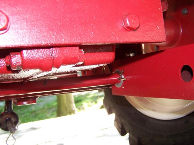

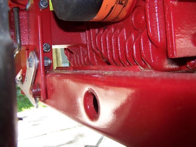

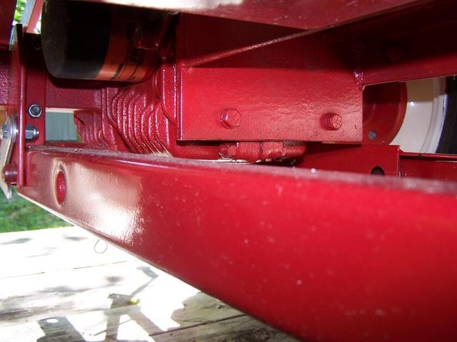

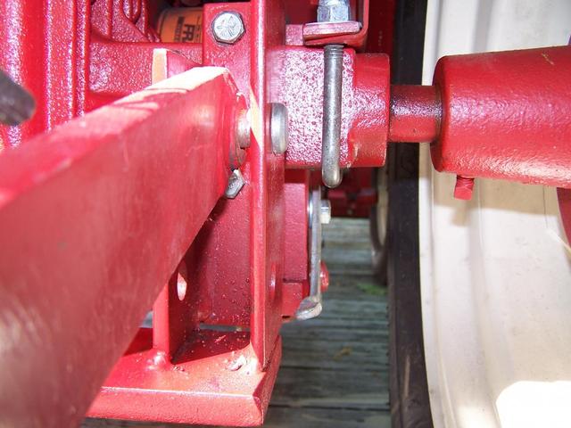

ThreeHorses 20 #7 Posted December 8, 2013 I have both a GT14 plow and 300/400 series plows. Some possibilities: Plow without numbers on it I got with 1 GT14 had a couple angle brackets bolted to the top of the A-frame. They lowered the A-frameabout 1-1/2" or is essence raised the rod that attaches to the axle bracket. This would lower the A-frame and give you slightly more clearance under the front axle. The other GT14 I had with a GT14 plow wasn't like this. Just had to adjust the link/chain on the lift so it wouldn't raise and hit the front axle. Do you have the wheelhorse 3 point hitch plow bracket? It may mount the A-frame slightly lower than the other brackets. I attached some pictures I had of GT14 with plow mounted. Really don't think it's the plow or A-frame. Share this post Link to post Share on other sites
KC9KAS 4,746 #8 Posted December 9, 2013 ThreeHorses.....My plow is hooked up just like the pictures you posted. Thanks! Share this post Link to post Share on other sites
