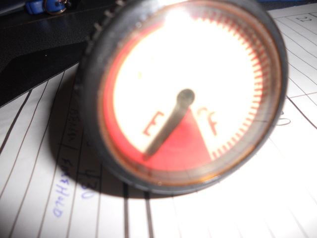

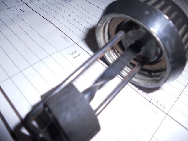

Bill Allert 68 #2 Posted December 7, 2013 Take a look at these pictures & let me know if it's what you want. I had a few of these NOS caps they look nice but remember they were for a short tank. The threads I believe are 1&1/2 inches. Its yours if you can use it. Bill Share this post Link to post Share on other sites
