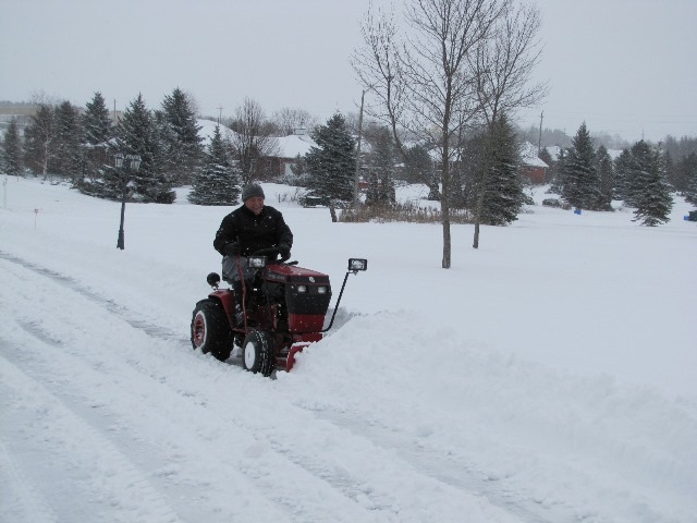

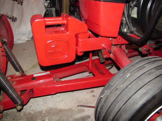

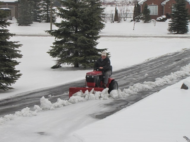

Hydro 131 #6 Posted December 8, 2013 My driveway is 300 feet long. At the beginning of the season I usually start off by plowing from the west side moving the snow to the east side so as not to fight the wind when it blows. My blade is always angled as far as it will go. Sometimes depending on the depth I might only take a foot of snow otherwise it spills out on the long end of the blade. Other times I may move as much as I can and come back a second time just to clean up. I go as fast as I can too. Front tires really make a difference and so does some weight. Last year I had my ribbed Vredestein tires on the front. This year I have turf tires on and will likely take them off and put the Vredesteins back on. I can't steer nearly as well with the turf tires. I built a front centre pin and weight bracket so I could move more snow without being pushed off course. It really makes a difference with some weight out front. When the snow begins to build I change up to the blower. As our winters change it seems we get cold and so for a few days and then rain. Having the ability to plow is really handy. This year I am going to try a single stage because it is easier to take on and off as well as store. These photos are taken over different winters with two tractors. 1 Share this post Link to post Share on other sites
