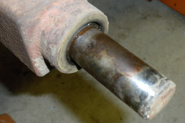

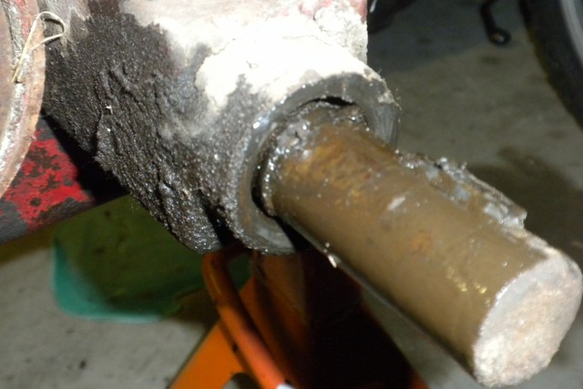

eightlitermopar 3 #2 Posted December 3, 2013 Here are what the axles look like with the hub removed. It looks like the one side has had a leaking problem for a while.... Share this post Link to post Share on other sites

eightlitermopar 3 #4 Posted December 3, 2013 Thanks for the pictures lane ranger! The reason I am confused is because I don't think my axles have seals! I was looking but could not find anything. Perhaps this is why it is leaking? The hubs came off fairly easily, the one side needed some tapping with a hammer... I see that some sites like mowparts.com still have seals under the number 83-2840, would this be correct for my axles based on my photos? Those little jokers are 20 bucks each, so I want to get it right! Thanks again! eightlitermopar 1 Share this post Link to post Share on other sites

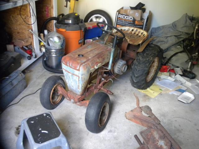

stevasaurus 23,580 #5 Posted December 3, 2013 (edited) It looks like (in picture # 3) that you have the cast iron 2 piece transmission WH # 5007. If that is correct, then you need the SKF # 9815 seals. The ones I bought last year were $2.77 each at Motion Industries...NAPA should carry these also. The WH # 1232 crosses to SKF # 9815 and in this picture, there are 3 of them on the bottom right in the 2nd picture...!st picture is of what I think you have ( 5007 trans) The 83-2840 seals are for the 3 piece transmissions (center casting with 2 steel side plates). This is a cap seal and that price is correct...you can only get them from TORO. I can't believe I do not have a good picture of the cap seal, but you can kind of see it on the axle housing on the left side of this picture of a 3 piece transmission. The seal actually sits on the out side of the axle housing and the cap is about 1/4"... Edited December 3, 2013 by stevasaurus 1 Share this post Link to post Share on other sites
eightlitermopar 3 #6 Posted December 3, 2013 (edited) Thanks for the pictures! I definately have the # 5007 transmission with the 1 inch diameter shaft. I looked online at napa (whose website is being very slow for me this morning for some reason), and it appears that part number 9815 has a couple of applications. http://www.napaonline.com/Catalog/CatalogItemDetail.aspx/Manual-Steering-Pitman-Arm-Shaft-Seal/_/R-NOS9815_0297818337 I also looked at the motion industries and found this, which looks more accurate, but I've never really seen one in person so who knows? http://www.motionindustries.com/motion3/jsp/mii/product/01295997/SKF+Sealing+Solutions+9815+Oil+Seal+-+Inches/en?category=Seals%2C+Gaskets+%26+Accessories%3ESeals%2C+Rings%2C+Washers+%26+Seal+Accessories%3EOil+Seals I may be better off with the motion industries piece, especially if someone here has already used it and it works. what do you think? eightlitermopar Edited December 3, 2013 by eightlitermopar 2 Share this post Link to post Share on other sites
