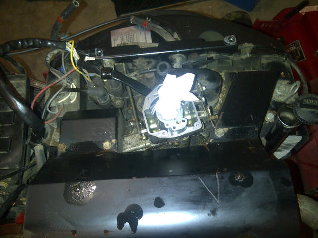

Martin 2,135 #11 Posted December 8, 2013 you still have something in the fuel system if its not running smooth. might be in the rest of the fuel system, but i bet the carb still has some junk in it. either you missed it or when you put it back together something in the fuel system made its way to the carb. i would start at the tank and work forward. if you just do the carb, whatever you miss in the rest of the system is just going to undo your work. im not sure how much cleaning you did other than soaking in sea foam. i had a similar issue with my 416, heres an excerpt of the thread '416 adventures'....... ............................................................................. well i got impatient waiting for the sea foam to do its job and tore into the carb tonight. i read a few posts on here about just cleaning the carb on the engine and thought id see if that would help. heres one such post…. I've been inside nikki carbs used on performer engines before so i knew what i was going to see when i pulled the top off. the main running problem was at idle and mid range. well it had no idle at all so that was where i started looking. besides a whole bunch of junk in the bowl (which the sea foam wouldn't have got out in 1000 hours of running) the removable slow idle jet was blocked in the bottom 3 holes with junk. heres a pic of that brass jet and where it goes…... then i blasted carb cleaner in all the passages and bowl, cleaning as much as possible. removed the mixture screw and cleaned through as well. removed the main jet plug and jacked up the back of the tractor to allow all the junk to flow out into a rag and container to stop making a mess all over the engine. re assembled the carb and primed it with gas ( using the mouth blow on the gas tank opening……. ) and she fired up and now runs nice and smooth…... thanks didn't run it with the air cleaner and breather was a little noisy at idle………. take a look at the video…... 1 Share this post Link to post Share on other sites

Foozerush 40 #13 Posted December 9, 2013 (edited) Thanks for the pics Martin. Hopefully I'll never have to dig into my carb, with proper maintenance I'm practicing with a can of Seafoam, but I'll know what to look for if I ever have to do that. And look up this thread for them. Glad you got her going with the second cleaning!! Now Work that Horse!!! Edited December 9, 2013 by Foozerush Share this post Link to post Share on other sites
