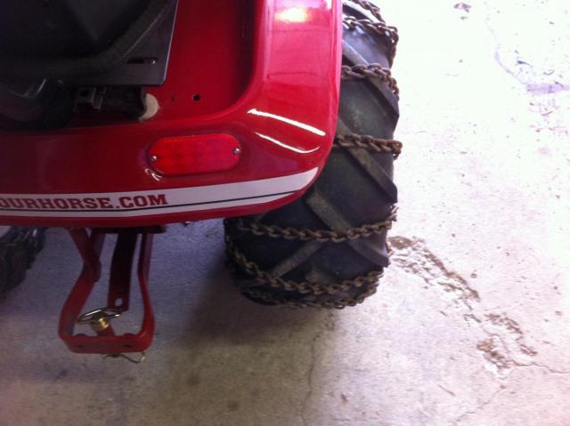

meadowfield 2,808 #4 Posted December 2, 2013 (edited) offset is trickier with the rear mounted tank. I had to change the centres on mine to get clearance with 10" rims Edited December 2, 2013 by meadowfield 1 Share this post Link to post Share on other sites

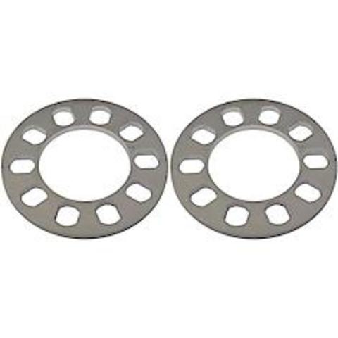

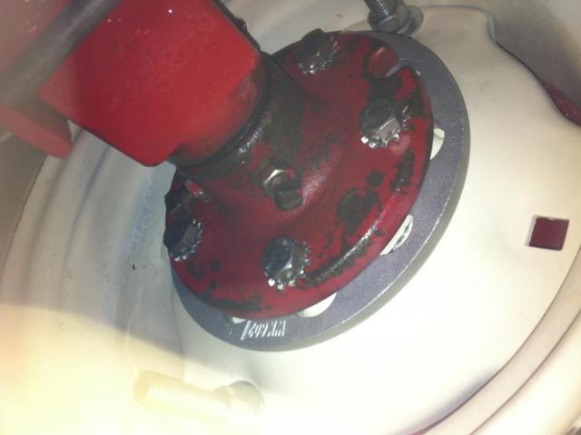

squonk 44,644 #5 Posted December 3, 2013 I put 23x10.50x12 AG's on my C-145. After installing chains they hit the gas tank. I got some wheel spacers from Advance Auto and got some longer wheel studs. Now they clear. 1 Share this post Link to post Share on other sites
Coadster32 793 #6 Posted December 3, 2013 Love the look of the "fatties" on the back as shown by Meadowfield. Good fab job on the alteration as well. (Although I do think Squonk's approach might be a bit easier) Share this post Link to post Share on other sites
squonk 44,644 #7 Posted December 3, 2013 (edited) Here's kinda how the spacers fit. I think I used 7/16" X2" fine bolts for studs: Edited December 3, 2013 by squonk 1 Share this post Link to post Share on other sites
